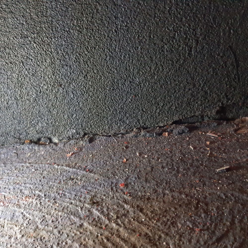

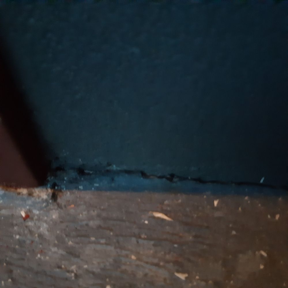

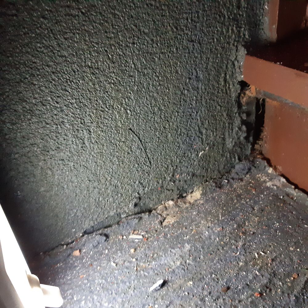

My townhouse was built by unskilled trades persons. I have this uneven gap between the rendered vertical wall and the concrete driveway. I suspect the two edges need cleaning up to be straight/even ? maybe not ? Then some kind of concrete (?) to fill the gap ?
The solution needs to be practical to seal the space and also asthetically pleasing (as this is near the front door entrance).
Hi @wendyf1,
The solution to this issue is to apply a bead of flexible sealant such as this Sika 600ml Concrete Grey Sikaflex 11FC Purform.
Start by giving the area a good clean and chipping off any loose concrete or render.
Use some painter's tape to mask off the wall and ground allowing for enough sealant, around 5-10mm wide, to fully cover the gap.
Apply a fairly thick bead of Sikaflex between the tape, then strike it off using this Paint Partner 4 Piece Silicone Scraper Set. I'd suggest using the corner of the scraper I have pointed to below.
After striking off the silicone, while the silicone is still wet, pull the tape to create a perfectly straight edge.
You might like to check out How to use painter's tape and How To Silicone a Gap for some further guidance.
Let me know what you think.
