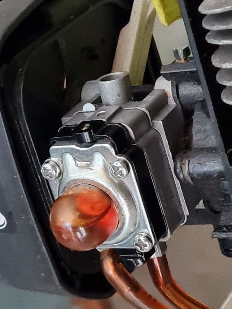

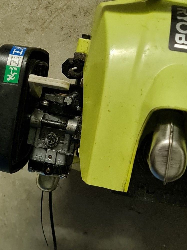

Hi Mitchell,  My Friend Ross, did the same as I did, the RLT26CDSE, checked the carby dismantled it cleaned using carby cleaner. still no fuel getting through put 5 drops of fuel down air intake. Started and ran for short time when fuel ran out.  The the RLT26CDSE carby has an adjustment in an aluminium tube like bit, the round bit for adjustment could not be gripped by very pointy plyers. Or any other way we tried. At that point I told Ross I was going to buy a new carby. Ross then used a wire that cut the metal away, so could grip the adjustment, THAT WAS BLOCKING THE FUEL TO CARBY and away the trimmer went!! this adjustment Part-RUIXING Dot 2mm Carburetor Adjusting Tool for most Ryobi, I will buy one. This adjustment bit has not been adjusted by anyone, can only assume it has vibrated slowly to the closed position. I will mark it with paint to see if it continues to move through vibration. Also I have ordered the Carburetor Kit for Ryobi RLT254CDSO RLT254CSEON - Includes Air Filter & Hose. And have fitted it, started it and have adjusted the revs to be usable. I could not get the revs right but will keep it in reserve and use the original one as it is flying.
The new one has an adjustment that is very different to the original, being only a slight difference only.  See pics attached.
