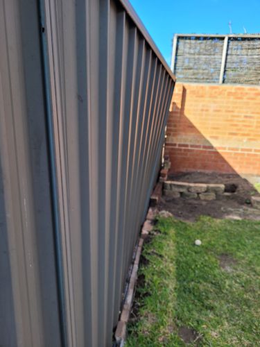

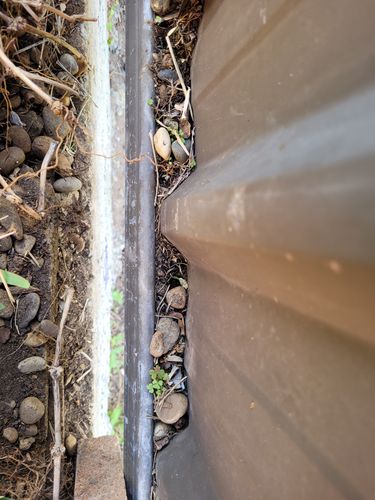

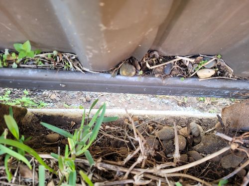

Hi, We have a back fence that has a gap underneath. Unfortunately the neighbour behind's land drops about 60-80cm below ours.  Our dirt is falling into her property.  We have tried to communicate with her but unfortunately she doesn't want to have a discussion.  Also the fence is crooked at one end due to them fixing it many years ago.
We need to fix from our side but not sure how, we also don't want to put trees or plants, happy to butt up with grass.

Thank you Mitchell. I should if included phitis from the beginning (see attached).

Hi @Matthewsl,
Thank you for uploading those images.
The method of installing a plinth that my colleague @MitchellMc has described would be the best way to prevent the soil falling through the gap.
You might also like to check out Bunnings range of garden edging, which is also an option and offers some more variety in terms of aesthetic.
Both the plinth and garden edging can be installed with pegs such as Jack 270 x 20 x 3mm Zinc Plated Garden Edging Peg or 400mm Plinth Peg Galvanised Steel hammered into the soil.
The post leaning over is likely only repairable from the other side of the fence as you do not have access to its attachment point. Unfortunately, you may have to reach out to your neighbour for access to their side in order to assess the post for a repair. If you were able to gain access and could provide photos, I would be happy to assist.
