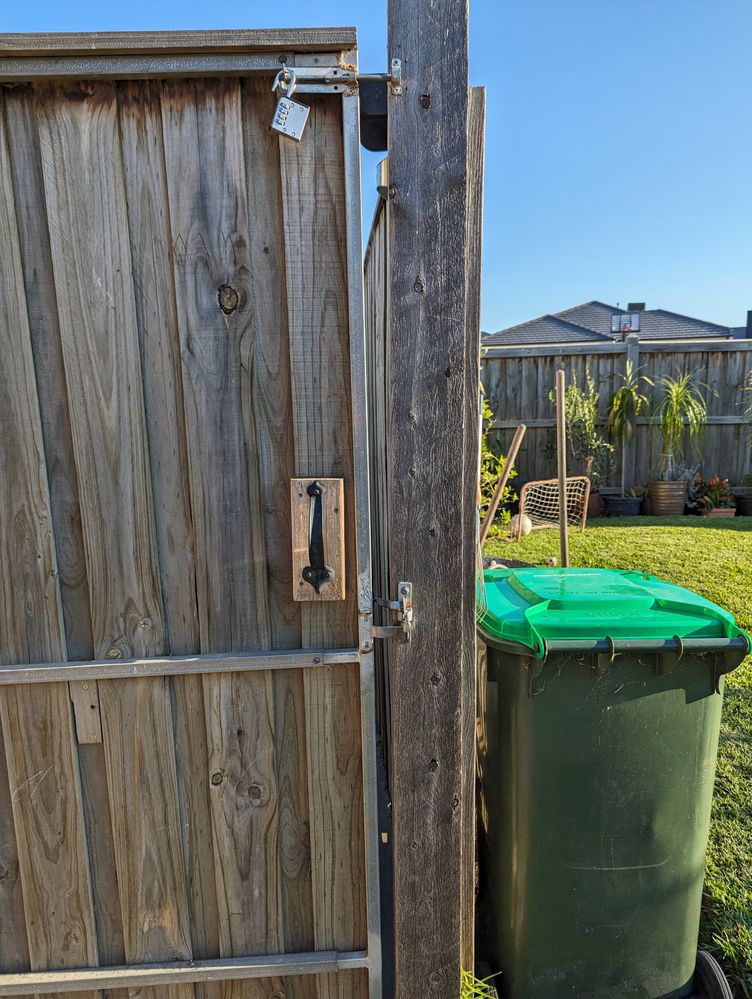

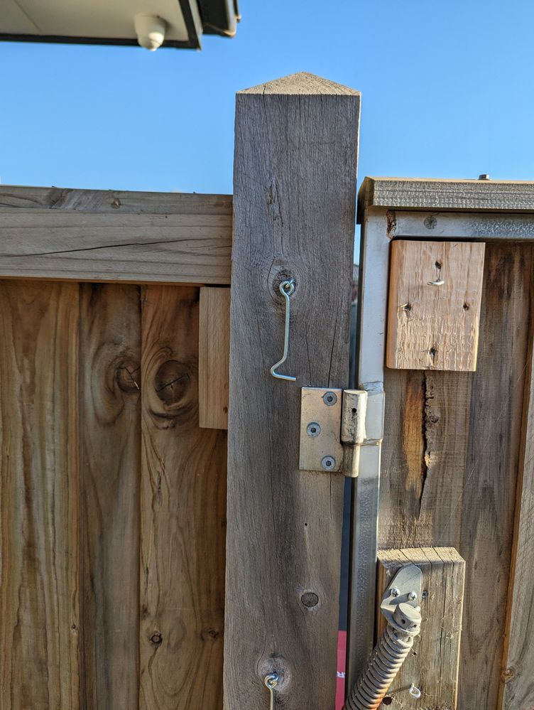

Hi @PatDIY_Dad,
Moving the top hinge further over would be the simple solution. How long that lasts really depends on how active this twist is. It could be a good short-term solution and would certainly beat having to dig out the concrete footer and install a new post. I suspect that the screws on the right of the hinge plate are going to land right on the edge of the post, so you might like to install a block of timber onto the post first to capture them. Adding additional holes would be an option, too, as you've mentioned.
Let me mention @Dave-1 and @Nailbag to see if they have any other suggestions.
Afternoon @PatDIY_Dad
Why are gates always pains is my question?
My gate is currently jamming due to the fenceling doing wht yours is (excpet mine is heaing towrads the gate not away from it)
Easiest way to do it as I hate shifting hinges and as @MitchellMc says if you move the hinges it will be right on the edge of the post and you will need to put in a timber piece to screw it to (down the length of the post type deal)
You could put a Facing piece of timber (think the thickness of 30mm) on the Freestanding post and trim it at an angle so the gate frame will look square..
Top of the post is 30mmm wider then the post, bottom of the post matches with the post and you screw the whole piece of timber to the existing post. Then put back on your latch and locking bolt. The "air gap" wont be noticible and the right hand side will be inline with the post.
Thanks mic might try that
The timber to add on won't be able to be very thick though as the gap difference to make up is only maybe 15-20mm
Might be tricky to screw into that
I could also plane the post to try make it plum again

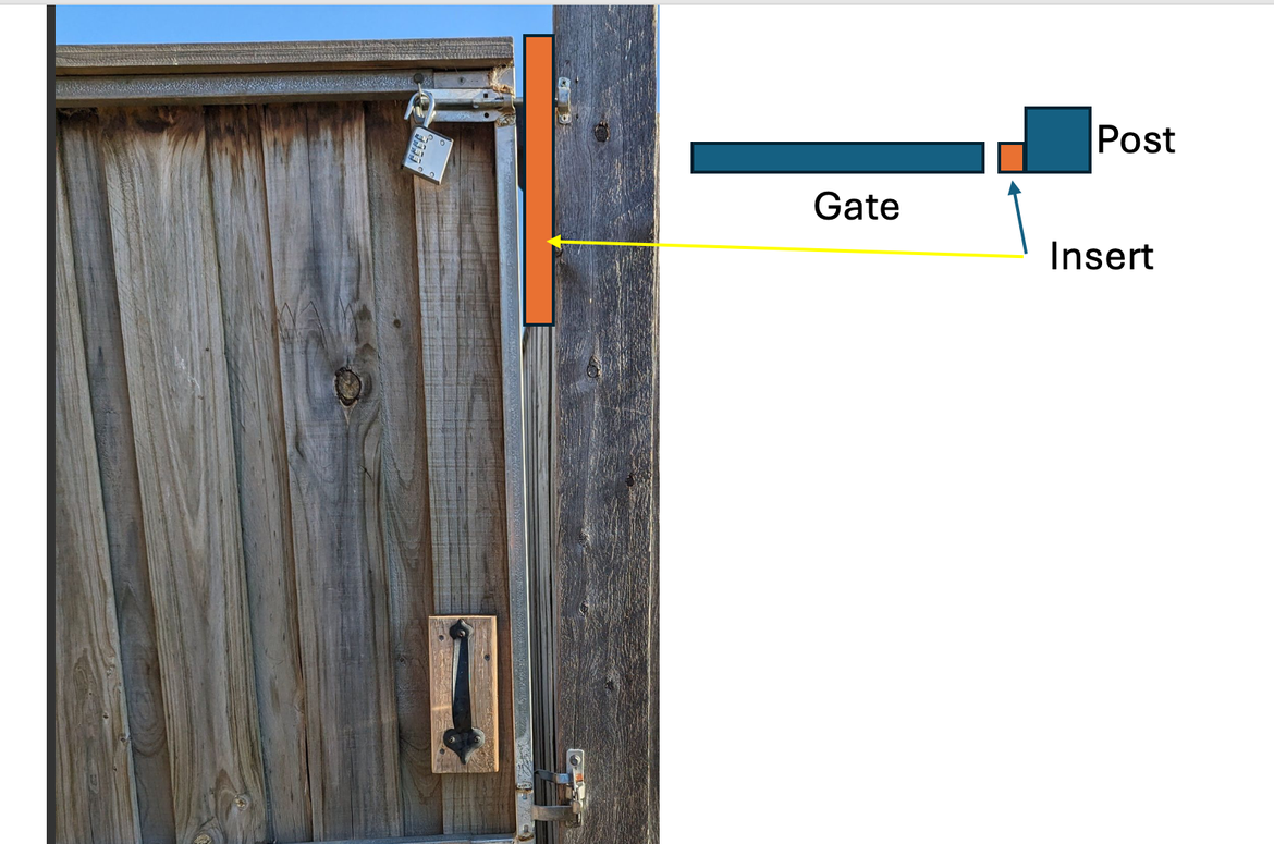

Hi @PatDIY_Dad A simple solution in lieu of replacing the post with say a cypress one could be to add a small piece of treated pine timber (20mm x 90mm x 200mm) to close the gap as per the attached photo and relocate the bolt loop. I'm a huge fan of these self adjusting pad bolts. I use them on every gate these days as they compensate for timbers moving in various weather conditions.
Regards, Nailbag
Thanks yeh I had some 15-20 mm treated sleeper off cuts.lying around and screwed it into the post and relocated the bolt loop thing
Not as secure as sky could unscrew the added sleeper ( would need a drill) and take off the bolt loop from open the gate
But they could easily jump it if they really wanted to get in
I just need to borrow a.planer.to make the left post less twisted
