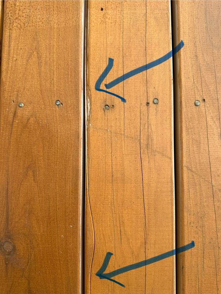

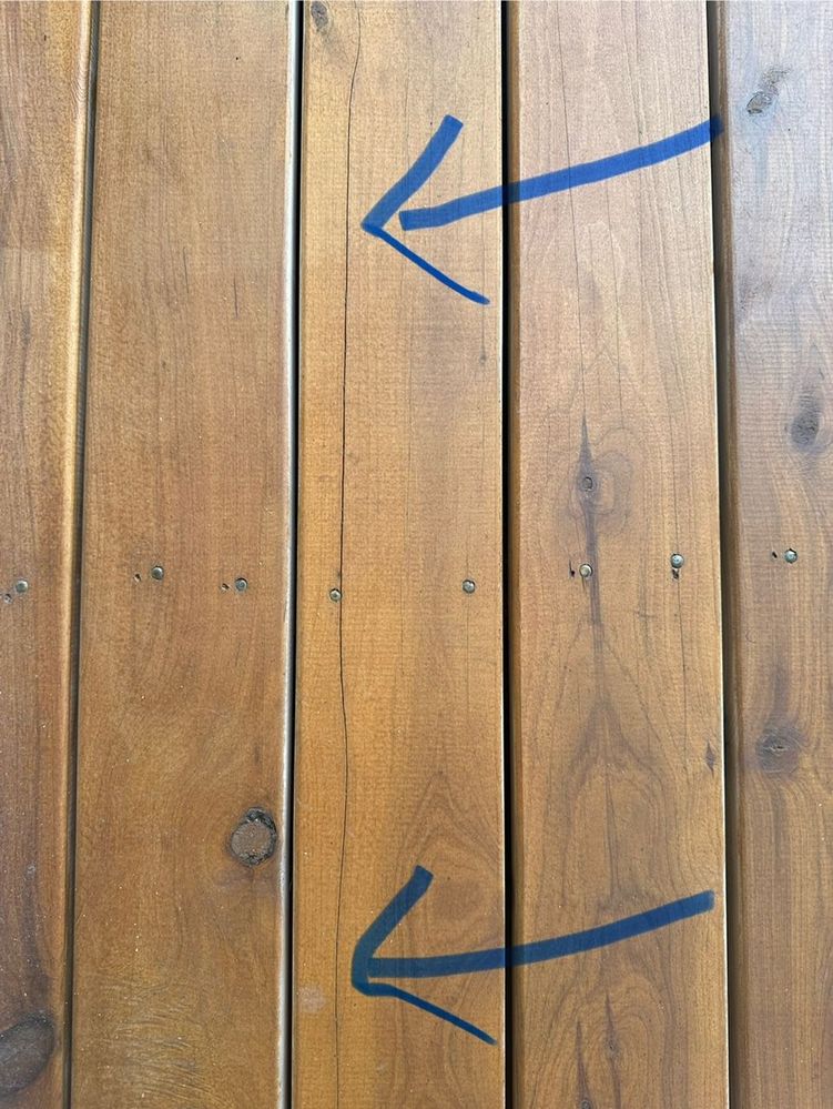

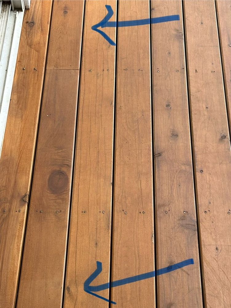

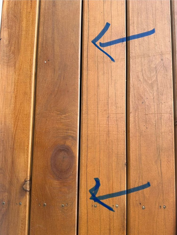

New decking boards have been laid and we’ve noticed that there is a split in one of the boards near the entry door. The split is about 2m long and is approximately 2cm at its widest to almost nothing at the end (a long triangular shape). Any suggestions on best way to repair? ThanksTotal lengthWidest sectionMid sectionNext to narrowest sectionNarrowest section

There's no way I can think of that would fix this issue. I think it would either be a case of leaving it be and seeing if it causes issues ( I do see there is already a chipped section) or pulling up the board and replacing it. If it's really bothering you, I'd suggest pulling up the board and replacing it. Do you have any of the deck stain left so you can ensure the replacement board matches?
Can I just confirm that it's actually a crack? In some areas, it looks to be, but in others, it clearly looks like some heavy object has been dragged across the surface as below. If it is a drag mark, it appears as if when the object was dropped off the side of the board, it caused the chip. I guess that's irrelevant, though, as if it's bothering you it needs to be replaced.
Thanks Mitchell
It’s definitely a crack as it moves when touched/walked on. I can live with the chip.
