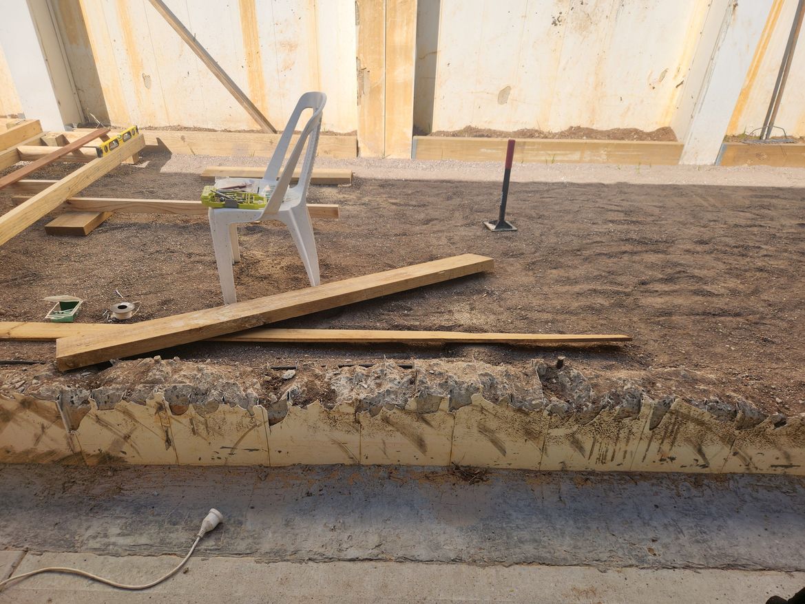

I am doing my backyard project with a 2.5mt deck and will pave the rest.
There is an uneven retaining wall which is a spot of bother. Can I get some ideas how to cover it. Attached are some photographs.
Width is 20cm

My first suggestion is to cover the retaining wall with Merbau decking panels. This will give it the illusion that it is part of your deck, and you won't have to do a great deal of concrete manipulation. Another method to modify the retaining wall is to create timber form work around the surface and top it up with new concrete. You can then render and paint the wall to give it a fresh new look. Your decking frame looks good, I can't wait to see the finished product. Please make sure to post an update once you have everything assembled.

Yes, there is the 200 x 50mm 2.4m Merbau F27 Pre-Oiled KD DAR Beam, but it is still possible to build it out of ordinary 90x19 Merbau decking panels. It will be necessary to create a rectangular frame design with 70x35 so that you can wrap the retaining wall with the decking panel.

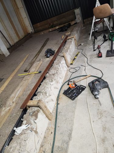

Now that is some impressive "Removing the retaing wall" effort @RonnyDeol 🙂
I was thinking as I was looking through your photos of how to cover it up...
Is your plan for the width of the deck set in stone... 🙂 yes I see the pun 🙂
I propose extending the deck an extra 2 feet towards and over the retaining wall (it looks like your deck will make it over the wall?). Like a cantilever type deal. You could even support the support beams off the concrete retaining wall. You would have a "face" on the edge of the retaining wall that would cover the jagged edge of the old retaining wall.

I have started putting up a frame.
Have a look..
Thank you for the update, to prevent the panel of the retaining wall from being bouncy should anyone decides to step on it, I suggest keeping the gap between the frame to 450mm to 500mm. this will make the panels very stiff and provide adequate support should anyone decide to stand on it.

It would probably help with the stability of the frame. Any extra support is always worth putting in.
I think the suggestions from both @EricL and @Dave-1 provide an ideal solution to covering the retaining edge. I am more concerned about the stumps/supports I have highlighted with red circles. I was wondering if these are just temporary supports with concreted in stumps yet to be installed?
Without knowing actual span lengths you will need at least 2 stumps per joist and noggins with a single level sub-floor to prevent twisting of the joists. The photo below shows the type of plan I am referring to.
