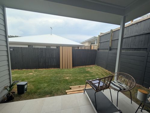

IMG_8100.jpgHi There,
Looking for some help regarding our fence line idea. we was thinking about adding this cladding (link below) to our fence line. we wasn't sure if this is something that can be tacked onto pour existing fence with a couple of extra posts attached for fixing or it needs a whole new structure built to attach to? Thanks.

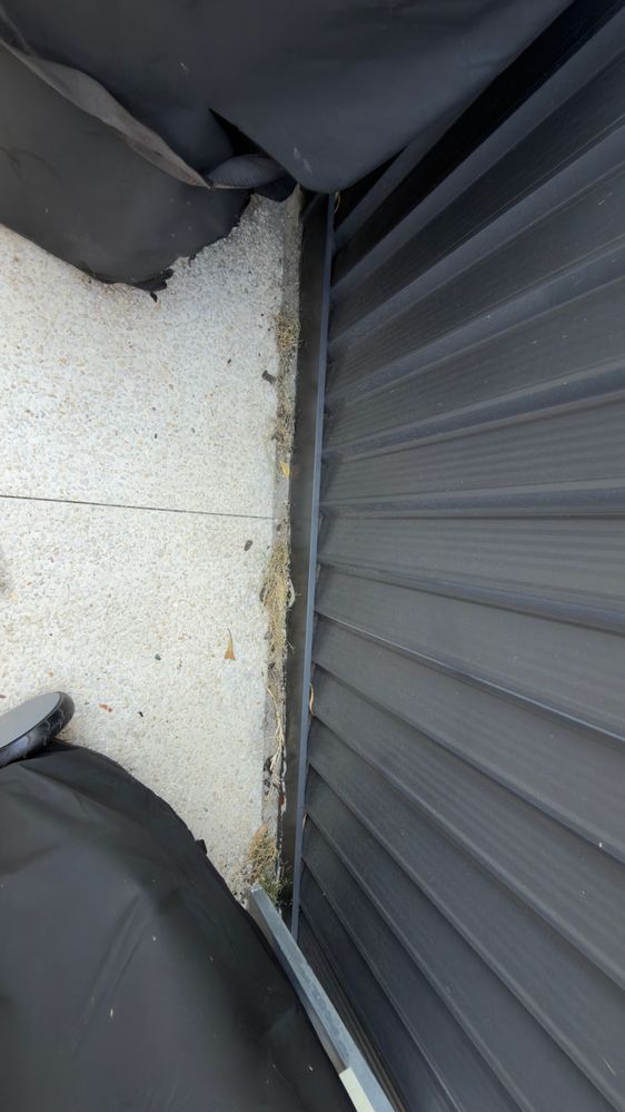

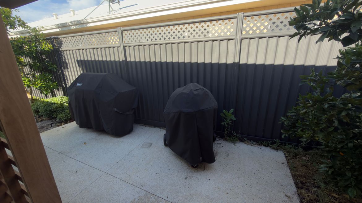

3. From point 2, You can see from my images that on the outside of the concrete I can see that I can set some posts down as it's just soil however I am guessing I also need a post in the middle?  Infront of my fence the aggregate sits pretty close to the fence, how exactly would I get a post set down in there for the middle one as I can't really dig down there?

Also, iInfront of my fence is some exposed aggregate so I don't have a lot of room,

  • If your fence is 2.2 meters tall, you can only go up to 2.2 meters as anything past the height of the fence will be in violation of your local council fencing rules. The panel you purchase will need to be cut down. If you are referring to the height of the post a 2.7meter post should be tall enough for your needs.
  • You'll need to dig a post hole about 600mm deep and concrete the footing into the ground. Have a look at this guide - How To Build a Fence, it will show you the general steps on how to install the posts.
  • It will be necessary to determine if you have a concrete base underneath the large pavers. If there is a concrete base, I suggest digging at the side of the paved surface to determine how thick the concrete base is. If it is very thick say around 75mm to 100mm the post can be connected to the base surface using a galvanized stirrup.
