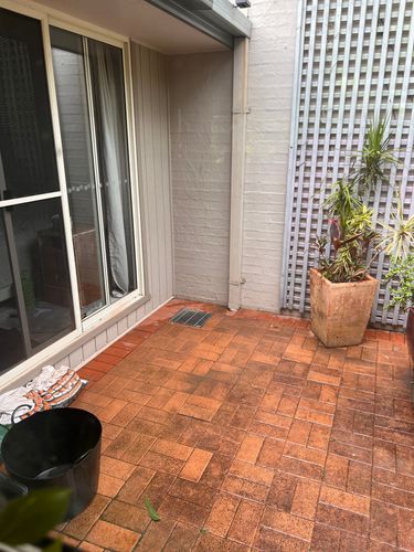

I’ve had issues with water going underneath my house installing a drain was a failure and made it worse in cyclone, can anyone recommend what I should do I’m at my worst right now health wise and so over trying to fix this problem, I’ve just thought this morning maybe I should get a landscaper to reslope the courtyard or build a deck on top or roof it the neighbours house is pouring water into my area and it is just getting worse I’ve already had so much done and with limited funds done mist myself but am I just going to have to sell this house , the idea is them get it ready to rent so I can take a break to get my health on track

It sounds like there’s quite a bit to unpack here, and more details would be helpful in understanding the full extent of the issue. The first thing to clarify is whether the water going under your house is actually entering the dwelling or causing damage. If not, water flowing beneath a house is quite common, and unless it’s leading to structural problems, it may not be as critical a concern as it seems.
Regarding the courtyard flooding, could you provide more details on why the drain was a failure? In theory, any significant water buildup should take the easiest escape route, which would be the drain. Did the drain become overwhelmed due to the volume of water, or was there an issue with installation or grading? Also, does the area flood under normal rainfall conditions, or is it primarily a problem in extreme weather events like cyclones? If the drain is ineffective even in regular rain, there may be a need to reassess its placement, capacity, or the overall grading of the courtyard.
The water from your neighbour’s property is another key factor. Could you describe exactly how it flows into your space? Is it running off a hard surface, like a driveway or roof, and directly into your courtyard? If so, is there an opportunity to have a conversation with your neighbour about redirecting it to their drainage system? If their runoff is significantly contributing to your flooding, property owners are generally responsible for managing their own stormwater.
If regrading the courtyard is an option, that could help improve drainage, but it depends on where the water has a natural path to exit. A deck or a roof might provide some relief by covering the area, but they wouldn’t necessarily solve the underlying drainage issues. Since you’re considering renting out the property, any solutions would need to be long-term and practical.
If you’re feeling overwhelmed and limited on funds, a landscaper or drainage specialist might be able to provide a professional assessment and prioritise cost-effective fixes. Let us know more details, and hopefully, we can help work through the best approach for your situation.
