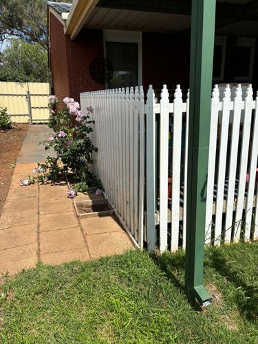

Picture 1: Front left downpipe (left when looking directly at front of house)

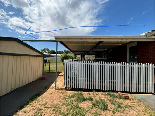

Picture 2: Front right downpipe

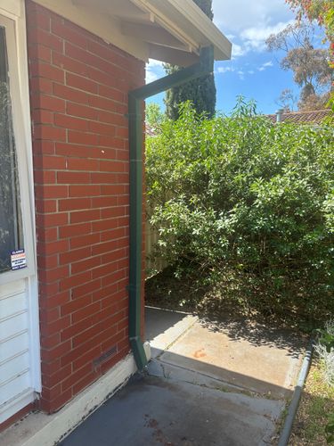

Picture 3: Back left downpipe

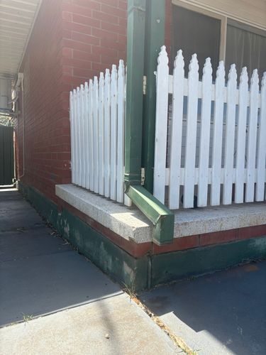

Pictures 4: Back right downpipe that runs onto the top of our shed (most significant damage to house stumps on this corner. Earth is wet underneath. Also the lowest corner).
We’ve had a plumbing company come out who have recommended that the two downpipes on the front of the house to be connected to the street storm water. Our ground is higher near the footpath and continues to slope down towards our house and across our property to our back fence. I questioned how the water can flow towards the storm water as water doesn’t flow uphill. Do they lay the pipe underground on an angle? He replied that the pipe will be laid level and water will always sit along the bottom of the pipe.
He recommended that our back downpipes be connected to a new rainwater tank (runs off our shed) but doesn’t believe a rainwater tank will be enough. Estimated price will be emailed soon but have been told it will be a ‘shocker’ due to the many difficulties. Would very much appreciate a second opinion 😊

This part of the job seems unavoidable because currently, your downpipes are discharging onto a hill that runs back towards your house. To me, this is a critical issue that needs to be addressed.
In the process of installing stormwater pipes, you could also have some drainage channels run along the front of your house to capture any water that is flowing down towards your home from your front yard and the street and divert it away from the foundation.

The rear downpipes, well the right hand side could join to the one going to the street. The left could still go to a water tank (just larger) that depends on if you use the tank water? Where does the water from the sheds roof end up? Maybe you could do the same think along the fence line on the other side of the tank? I do like the idea of a large water tank espically if you use the water activly

Just to add to the suggestions made, I propose adding two slim five thousand litre tanks at the back. In this manner you maximize your water storage capacity and have the overflow of the tanks pointed to the back of your property or piped towards the storm water drain. This will at least reduce the number of channels to be dug.
