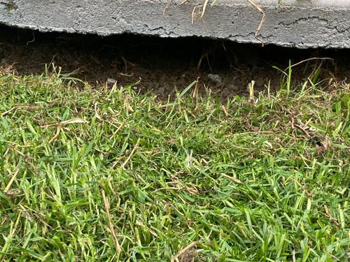

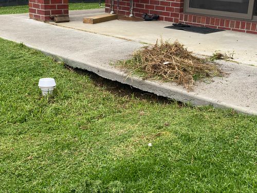

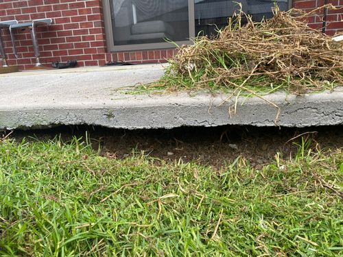

Hi there
can you please advise how this gap between the ground and concrete slab can be fixed ?
Is there DIY or have to get professional assistance.
Thanks in advance.

Annoying but fixable ![]()
It looks like the soil has settled form when that drain was put in and over time it has just dropped lower.
I would use some spare soil (not topsoil) and then a shovel at a time place it next to the hole, then using a piece of wood (something like a floorboard or a stud for a wall push the soil in as far as it can go, repeat as many times as you can and only push in small amounts until you can feel it compress firm.
Once you can push no more then I would slowly raise that dipped area with top soil, dress it lighly every few weeks and let the grass grow up through it, that way you wont have a dirty patch that needs fixing. Looking at the sewage inspection point, that should be level with your lawn so it may take awhile to build it up. You could also fill with topsoil and lay grass down over that whole dipped area. I know Bunnings stores get deliveries of grass rolls every so often. you could check your local one for when its due.
Hello @Mo2
It's great that you've received excellent advice from @Dave-1. I totally agree with Dave-1's suggestions in regards to filling up the gap under the concrete. Just to add to the suggestions made, I recommend doing a bit of investigation and having a look at the flow of water in that area during a heavy downpour.
I suspect that water is somehow finding a way underneath that concrete slab and slowly eroding the soil away. If you do find water flowing underneath, that issue will need to be addressed in order to prevent further soil erosion.

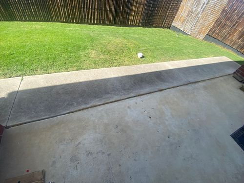

Hi.
I think you are right. Water is going from these gaps between the slabs and over the years it has compacted the soil.
Caulking on these edges could be helpful after filling the bottom gap with soil ?
I have cleaned this are but the weed actually make its way from these gaps so assuming water is making the way from here
Hi @Mo2,
Thanks for those additional photos.
I would suggest that a combination of water flowing through the crack and settlement from when the drain was installed are to blame for the erosion.
Filling the crack with Sika 11FC will help to stop water flowing down through the crack and eroding the soil further. Once this crack is filled, I would build the soil up from underneath like @Dave-1 has suggested, compacting it as best you can before bringing the surrounding area up using topsoil.
If you find that the soil continues to settle, there may be a small leak in the drainpipe that is causing the soil to erode away. If you find this is the case, you may need to contact a plumber to fix the cracked drain pipe.
