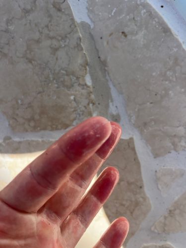

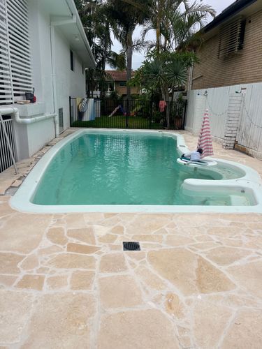

ive recently completed a crazy pave on our outdoor pool surrounds. It all went well apart from the grouting.
we grouted with a beige color and then unfortunately it rained heavy about 8 hours after completion
it did seem dry though
since then the grout has turned white
im not sure if it’s efflorescence and if it is what I should do
ive tried brushing it with a hard brush and it does slightly change the color but I’m not sure if I keep going in case I rub away too much grout.
when it is wet it still turns to a nice beige that I like so I’m not sure how to proceed
- keep scrubbing and then seal?
- try the efflorescence acid washer ?
- seal with a wet look seal?
thanks heaps in advance

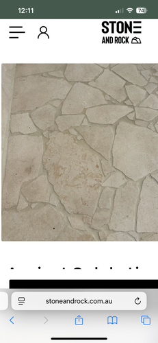

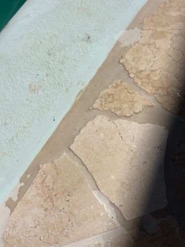

pics of the color the grout should be followed by pics of the pavers laid and how they look wet…
