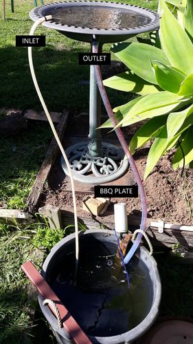

I like to recycle/repurpose stuff so over the years when I purchased a new BBQ I always kept the plates (both full and grill) before putting out for annual hard waste collection.
When I made the recycle/autofill birdbath I used one for the base.
