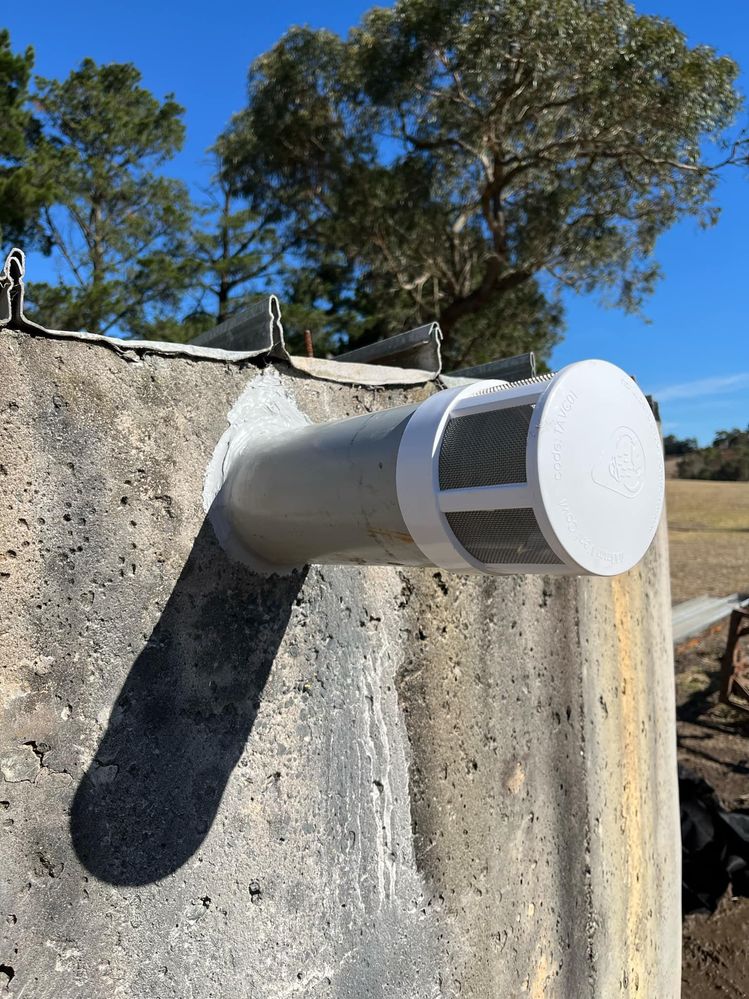

Sikaflex 11FC is a great product for repairing cracks and leaks in concrete water tanks particularly for DIY, its a polyurethane sealer-adhesive rated for use underwater and is suitable for drinking water.
  • Must be applied on the inside of the tank!
  • Tank must be clean and dry! use pressure washer
  • For best results use a 5 inch Dimond cutting blade to open up the crack in concrete to around 5mm wide and 10mm deep reason being is that this product is 35% felxible but if the crack is only 1mm wide that is not going to allow much movment!
