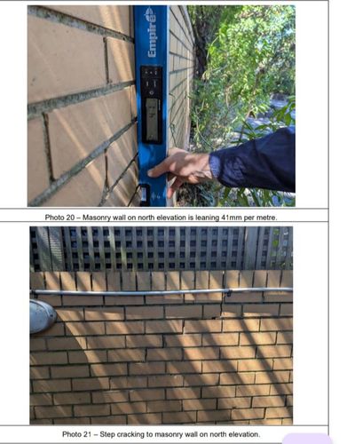

It has been identified by 2 independent structural engineers that our masonry fence is leaning. We are in an owners corporation. The fence is approx 160cm in height and runs along a common walkway. One engineer has stated that it is significantly leaning (41mm per metre) and is a hazard as it at risk of falling over.It also has significant step cracks.The other engineer has identified that it is leaning but is of moderate concern and should be supported or replaced within a 3 year time frame. Who do we believe? Both reports state that large trees planted too close to the building, tree roots are the likely cause.
