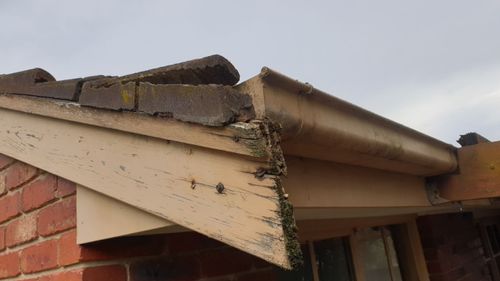

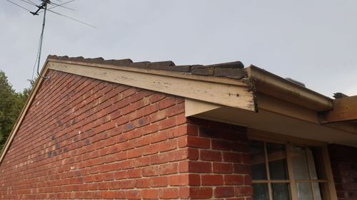

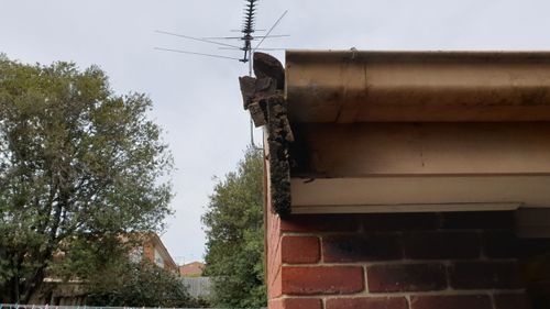

Hi all, need some help here. Moved to a new house and discovered the fascia board is rotting at one end due to gutters not draining correctly. There are roof tiles attached directly to the fascia board which are now loose. I checked yesterday and there is no water leaking in the roof but this might get worse if I don't fix this soon. Can this be a DIY job or do I need to call in the professionals? If DIY, what steps do I need to follow and what material would I need?
Would appreacite your help!

I've recently had almost the exact same repair done at my property by a tradesperson. Obviously, mine was more complex with the powerlines and not a D.I.Y. job.
I've included below a step-by-step D.I.Y. tutorial on how to How to replace a fascia which I trust you'll find helpful. Your repair will be very similar except you will need to lift that final row of tiles and then re-bed them with a bedding and pointing mix.
You might have already done so but you'll need to address the gutter draining issue or the timber will continue to be damaged. Just check you don't need to apply some Selleys 310g Roof And Gutter Silicone Translucent to the inside of the gutter around the end cap. It could have rusted through there if the water was pooling at that end.
Please let me know if you need further information or have any questions about the process.
