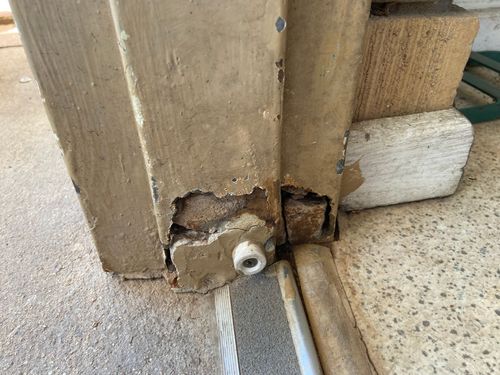

Hi. Not sure how to fix this- I have read other posts that say remove as much rust as possible, use a rust converter and then use turbo metal builders bog if there’s holes. Can I still use the bog if the rust is this bad or do I have to replace the frame??

Metal door frames are usually attached to your home for either structural purposes or fire safety regulations. I propose testing how far the rust has travelled and if it has totally eaten away the foot of the door frame. Once you've chipped away all the rust and have had a good look, you'll be able to determine if the rust damage is too severe or if it is surface rust only and can still bepatched with bog. Please post a photo update once you've removed most of the rust, we will offer our opinion regarding its condition.

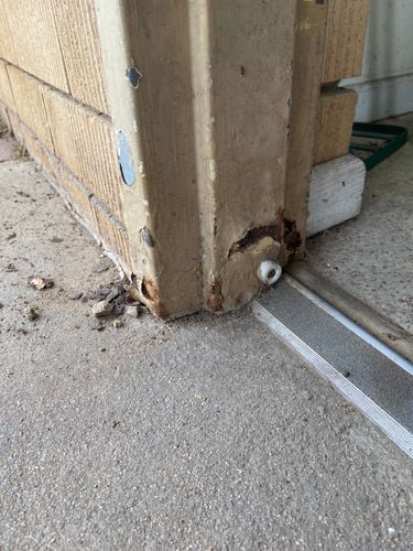

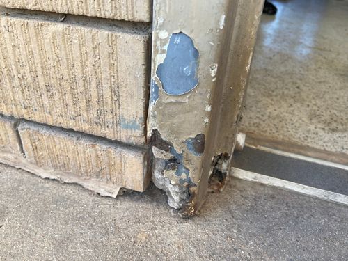

I’ve scraped away as much rust as I can and have uploaded photos. What do you think? Can I repair this?
Re: rusted doorframe
Hello @carmen2
Thank you very much for the extra pictures. It appears that an attempt to repair this frame has been done before. Parts of the cement footing have been exposed and what is left of the frame is laid bare. Due to the extensive damage on the footing of the steel frame, I propose replacing it with a new one.
However, should you wish to explore the possibilities of repair. I suggest engaging the services of professional builder and they will be able to assess the damage more closely and provide you with a definitive answer.

Sorry to say that is a 'to far gone' DIY project and you will need a qualified tradesperson for the repairs.

Another "It needs a builder" suggestion from me as well 😕 The level of rust around the whole base of the frame has deterioated to the point its not doing its job. I have never replaced a steel frame around a doorway but put it ino a class of "Need to learn before I attempt it" type deal. Its something that you want fixed correctly the first time.
