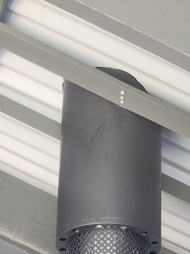

Hi guys, our poor plumber has accidently scratched the flue, any ideas on how we made the scratch less noticeable?

I just had a look at these White Knight 500ml Pot Belly Black High Temp Heat Resistant Paint I was thinking to repaint the whole top as being the easist but maybe the spray cans could work. I would use maybe the end of a plastic pen (the rounded end, not the writing end) to gently run along the scratch to remove the high points of paint and maybe metal. I was thinking a fine grade wet and dry sandpaper but think that maybe it will be adding to the issue. but if you do then maybe using the same end of pen with a strip ovver the width of the end and gently buff.
I like the pot belly paint over the spray paint only because I have used it years ago. And yes it did smell highly the first time or two it was hot.

Very lightly wet sand the scratch with some 400 Grit Wet And Dry Sandpaper. You're just aiming to remove any raised metal; you're not trying to remove paint.
Once sanded, use a fine craft brush to apply some black high-temperature paint.
