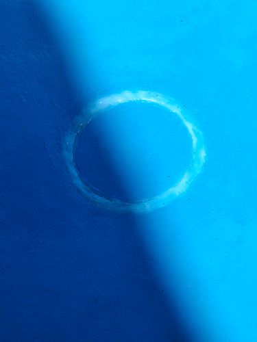

Hi Jacob, I follow you recommendation using SikaSill and after two days running no water loss in the pool. Thank you and the group imputed to resolve my swimming pool water loss issue.
I have attached the finished product.
Kind regards Henry

Hello @rosebay11 (Henry)
Thank you very much for the update, the repair looks good and it's good to know that your pool is not losing any more water.
