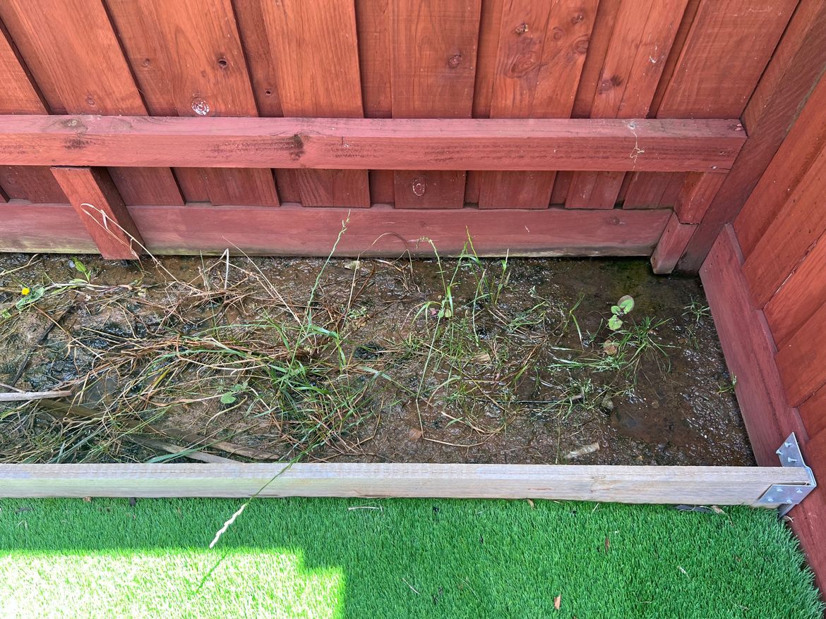

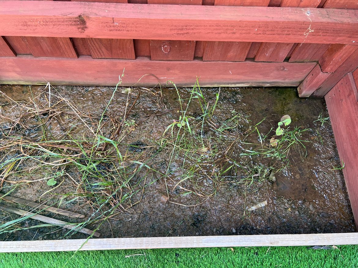

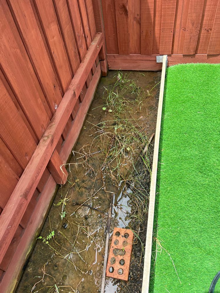

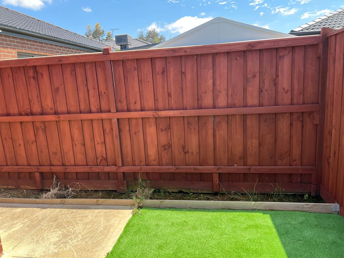

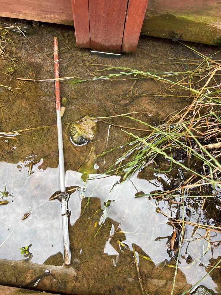

In our backyard we have noticed water is not draining properly from corner of the fence to parallel of fence for approx 390cm. I even dug approx 35 cm and remove soil & tried pouring little bit of water to see if it starts draining. However, water still sit on the layer. Because of this I can not plant any shrub or flowers or herbs. Please advised me the solution for it as for long run the water may damage the fence. For the reference, I have attached the photos for easy understanding.

It looks like that corner is staying far wetter than it should, so it may be worth having a quick chat with your neighbour to see whether they have the same issue on their side of the fence. If both sides are holding water, working on a joint solution would be far more effective than trying to fix only one side. From the photos, it does seem clear that this spot will need proper drainage installed. You could use a small pit drain to collect the surface water, or run an agricultural line along the length of that garden bed so it gathers the excess moisture and moves it away. Either option would need to connect into your stormwater system, which means bringing in a drainage professional. Given how much water is pooling and how persistently it is sitting there, adding a dedicated drainage point is almost certainly going to be the long-term fix.

The problem is that this corner appears to be the lowest point in your yard, so water is going to naturally accumulate there. If you distribute it along the garden bed, it will more than likely just come right back to that low point.

Thanks for your suggestion. I have dig almost 40 to 45 cm & make a slop so water can distribute to the other side. Even after digging what stays on top due to heavy clay. I am thinking to filled with new soil mixed with organic materials & gypsum to improve soil. Also thinking raised garden bed. Do you think it will fix the problem rather opting for drainage as it is very expensive.

I'm afraid adding soil will not fix the problem. Covering the surface with more soil will only hide the water, it will still be there underground and will not be ideal for gardening as the roots will be soaked in water and cause your plants to wilt and ide. A better alternative is to redirect the water out of your fence corner as the clay soil will not absorb the water and you will keep getting a small river in that corner.
