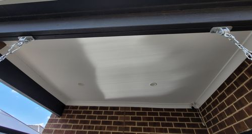

Thank you so much for your help. Turns out those two beams are hardwood and were laminated together. I hooked up to one of those.20240201_153830.jpg20240201_153815.jpg

I am a little concerned after re-reading over this discussion that I didn't put a warning in regards to attaching swings onto existing structural timber beams. Structural beams are designed to hold the load they were installed for. In this case, it was the roof. The original builder did not intend to have up to 300kg of weight and the forces involved with a swing attached to the beam. There is a significant chance that these additional forces could exceed the capability of the timber.
I do apologise that I didn't include this warning, but I think it's important to point this out regardless of whether the installation has been completed or not. I suggest enlisting the services of either a builder or engineer to verify that the beams are capable of this additional load. This suggestion is what I would have made had I included the warning.
