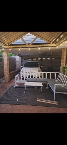

Hi Eric,
Thank you! This is the space between the brick pillar and the wall, to screen the car/garage. It is 3.5m long. We were looking at potentially using a 50 x 50mm aluminium post with a bracket of some sorts as these usually come in lengths of 3.6m.

Hi @bradkiera,
The aluminium post sounds like an option, but that's still quite a distance to span, and it will likely need at least one fixing point in the middle of the span into the ceiling joists. Given that, as Eric mentioned, you could likely use 66 x 42mm timber and screw it directly into the ceiling joists along the span. That would give you a vertical mounting surface to attach your blinds onto.
You'll be able to locate the ceiling joists in that area with a stud finder. here's a helpful guide: How to use a stud finder.

We were concerned about how heavy a timber beam may be (and have to confirm there are joists directly above to do this). Would an aluminium / steel post be less of a load than the timber beam?
Would you recommend we secure it to each side of the brick walls too, and do you recommend a particular bracket/ joist hangers?

The timber and blinds do not weigh a significant amount @bradkiera. The ceiling joists should be more than adequate to hold them up. Since there are ceiling panels installed there, it indicates that there should be joists behind them, which they are fixed into.
I can't see a metal pole between the beams being a much better option. You'll still need to brace it in the middle and connect to a ceiling joist there. That could be less structurally sound as it's only supported at one point in the middle rather than having the weight distributed across several joists.
I'm not aware of many brackets designed to support a post mount on a wall. We do have these Australian Handyman Supplies 50 x 50mm Internal Fixing Post Brackets, though.
