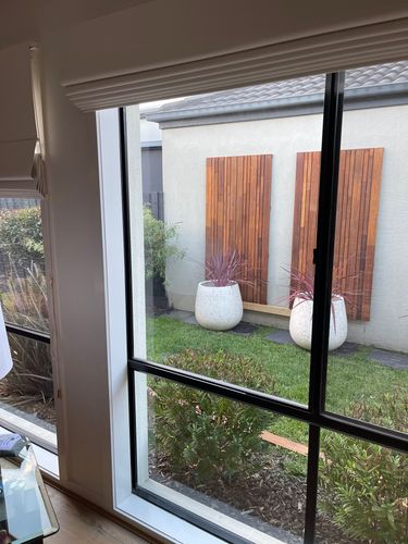

I am planning to place Merbau wall panels in my back yard wall. Please advise how can i mount them.
Product: Merbau Fence
Attaching picture of how I want it to be. Its a rendered wall on which I want to attach it.

Thanks for sharing your project of hanging Merbau outdoor wall panels. If you're getting SpecRite 1800 x 902mm 84/44mm Fence Panel Merbau Slats for your wall, I suggest mounting them on 70 x 35mm Outdoor Framing MGP10 H3 Treated Pine. This will provide a gap between the panel and the wall. Should the panel release any oil or tannins your wall will not get stained.
I recommend using Zenith 10 - 8 x 75mm Galvanised Countersunk Rib Head External Timber Screws - 10 Pack in conjunction with Ramset 8 x 50mm Universal Anchor - 20 Pack. Determine the approximate position where you want the panels to be mounted on the wall. You can have the timber mount as wide as the Merbau panel, but I don't recommend cutting it any smaller than 600mm. Place the mounting timber at the back of the Merbau panel. There should be one at the top and one at the bottom. Measure the distance between the top, middle and bottom of the mounting timber.
Using the measurements you've just taken, mark the wall where you'll be drilling into. I propose using a level to make sure that the mounting points are square. Drill into the wall and drill pilot holes for the mounting timber. Put the universal anchor in the wall and secure the mounting timber to the wall using the galvanized screws. Place the Merbau panel in front of the mounting timber and centre to your desired position. Drill one screw into the panel to fix it into the mounting timber and use a level to square the panel before securing it with a second screw.
Place another two screws at the mounting timber at the bottom. Repeat the process for the next panel. I've placed an illustration below to give you an idea of how it can be mounted.

would the gap of 3.5cm be enough visible from sides? I am also concerned about my white pots which might get stained. What options do I have there to protect them?
If you're worried that 3.5cm is too much of a gap, I suggest using Merbau decking panel, it's only 19mm thick and can be used outdoors. I recommend getting the one that's not pre-oiled to prevent staining your wall. I suggest painting the decking panel before you mount it on your wall. If you do use the Merbau decking panel please make sure to use a shorter screw such as the 60mm galvanized screw.
You have two options when it comes to your Merbau Fence panel. You can either use Intergrain 1L UltraPrep Timber Cleaner to clean and remove the tannins and oil on the fence panel. However, if you do this you'll need to paint or stain the fence panel straight away. Or you can let the fence panel naturally season for 6 to 12 weeks. Once all the tannins and oil have leached out you can then use your choice of oil and stain to seal the panel.
As for the white pots, I suggest relocating them to another area until the panels are ready. Once they've seasoned you can place the pots back in their original position.
