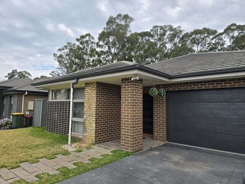

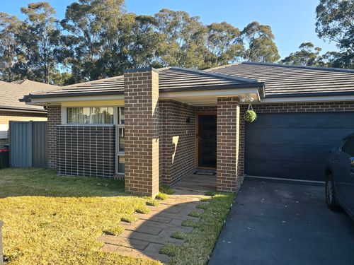

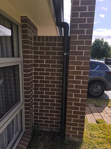

I have a downpipe running down at the front of the house. I'd like to cover this with some screening that blends in with the rest of the house.
Do you have any products that can blend in with the rest of the house ?
Preciously this downpipe was hidden by a brick wall however this had to be knocked down as it was pulling on the wall behing it. The wall is now repaired but I need to hide the downpipe.

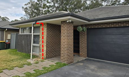

I would be tempted to move the downpipe to the corner but that will entail new joing the storwater pipes up and also making sure the gutters can carry the quantity of water at that point.

The first thing I would be doing either myself or engage a plumber is to reconfigure the down pipe to meet the wall. If you change it from a round to rectangular profile in the same colour as your guttering, it will provide a very acceptable profiled finish. @Dave-1 make a good suggestion to take the down pipe to the corner, however that would require the guttering to be reconfigured to instead fall to the middle, but to the far left but very doable.
