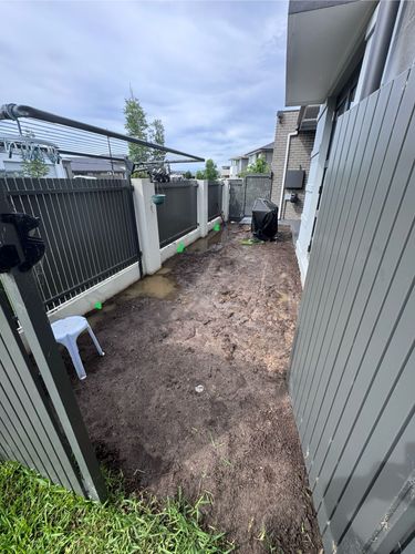

Hello experts!
Seeking some advice in relation to sorting out drainage issues in my enclosed courtyard area.

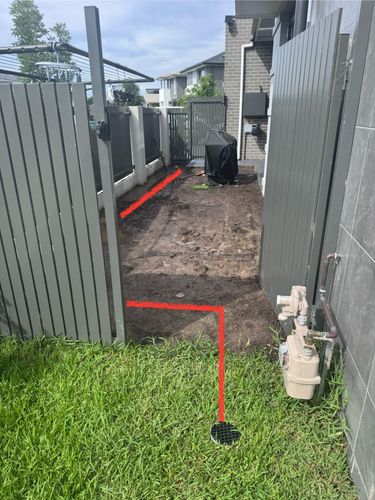

I was thinking of doing a french drain as per the photos attached (red line with yellow marks would be slotted pipe). This would connect to a storm drain located just outside of the enclosed area.
I would be looking at digging a 100mm deep trench, filling it with geotextile and drainage rocks before laying the slotted pipe.
In relation to connecting this pipe to the stormwater drain, will be using a plumber to make sure this part is done correctly.
An alternative option I thought of was drilling weep holes through the enclosing walls to allow water to drain outwards. The enclosed area is slightly higher than the grass outside.

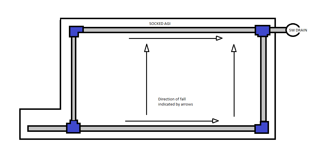

I'd suggest adding an additional French drain to the right side and the far end of your courtyard as I've shown below.
This way, all the important things are protected from groundwater and while you have the opportunity before turf goes down, it is worth futureproofing as much as possible.
The other tweak I would make to your plan is to dig your trenches deeper. Ideally, your French drains should be around 300mm deep, so they sit below the level of your home's foundation. The idea is they will capture any groundwater above them and any water that seeps through the earth to a level below them will dissipate into the earth well below the level of your house foundation.

Thank you for your speedy response and suggestion to improve the plans!
French drain plans

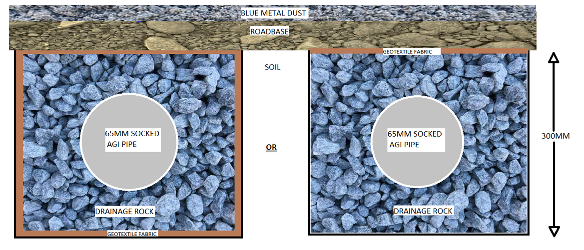

In regards to installing the french drain, would you recommend wrapping the socked agi-pipes with geo-textile fabric into a burrito (fabric, gravel, pipe, gravel, fabric) or would it be reasonable to just lay gravel + socked agi-pipe + gravel only without the geotextile fabric given that the whole area will be covered in road base and blue metal dust prior to the laying of synthetic turf?
Geo fabric layout
Looking at the vinidex products, should I be looking at using 100mm or 65mm socked draincoil?

No worries @Skimmo24, happy to help.
Your revised layout looks brilliant and is exactly what I'd recommend.
Best practice and my recommendation are to wrap the gravel in geo-textile fabric on all sides as this will prevent the surrounding soil from eroding and settling between your gravel. If you only put the geo-textile fabric on top of the French drain like in example 2, the soil could still erode sideways and settle between the gravel. These types of drains work by creating a path of least resistance through the earth. Having finer particles settle between the gravel will block the channels between the gravel which means it may no longer be the path of least resistance, and the water will eventually find a new path of least resistance.
The size of the pipe is relative to the volume of water it is likely to have to manage. There's nothing wrong with the pipe being oversized, but if it is too small to manage the volume of water, it can cause some issues. The initial cost to use 100mm fittings may be higher, but I always try to plan for the upper limit of what is possible, and you'll likely find the cost will even out as the volume of gravel you'll need will be reduced.

I have decided to just give it a go and have started to dig my trenches with slight deviations from the original plans above.
Thought i would post progress photos for those interested in whats going on.
Had to hire a 2m3 skip bin and by the end of trench digging, filled it to the brim. (For those thinking of hiring a skip bin, for reference, i dug a total of approximately 16m x 0.3m x 0.3m)
Will post more photos as the project progresses!
