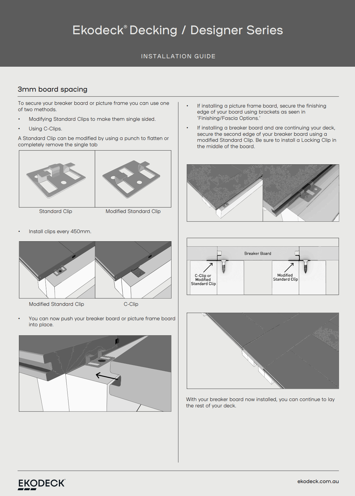

This may be a silly question but it isn't covered in any of Ekodecks manuals. When picture framing with an edge board, and using C clips on the front edge, what is used to secure the back edge when the other boards run perpendicular? Is a single edge of 450mm spaced C clips sufficient to secure the whole edge board?
Re: How to install Ekodeck picture framing edge board clips?
Hi @Flam30n,
In this situation, you would use a standard clip in the spacing of your choice, either these 3mm Standard Clips or these 6mm Standard Clips. These clips can be modified by bending down or breaking off the central tab so that they are single-directional.
You can find this in the Ekodeck Designer Series Installation Guide on page 12.
