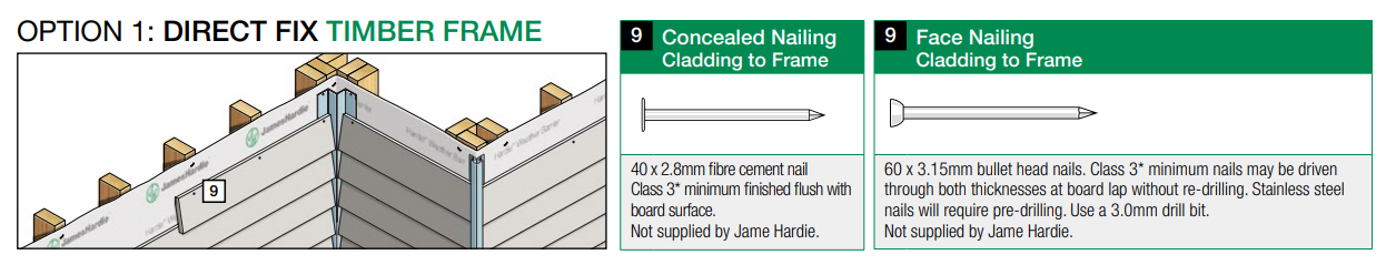

Here's the installation guide for them, and within it, you'll find the fixing options. The nails required differ depending on your chosen installation technique. If you can let us know more details on whether the boards will be fixed directly to studs, batons over studs, or batons over masonry, it will help us provide more info. Typically, if you are installing directly onto studs with batons, you'd use a 65 x 2.87 Galvanised Ring Shank Nail. Those nails can be fired through a gas framing gun. We also hire framing guns, which could be a good option.

Then that would be the timber frame option in the installation guide @JohnnyPC. So, the Paslode 40 x 2.8mm 2kg Galvanised Fibre Cement Nails for concealed fixings.

No, they don't @JohnnyPC. The installation guide doesn't actually provide an option for gun nailing and the direct fix method. However, I've just spoken to Hardies and they've recommended the Paslode 50 x 2.87mm Amor Galvanised Dekfast Impulse Nails.
