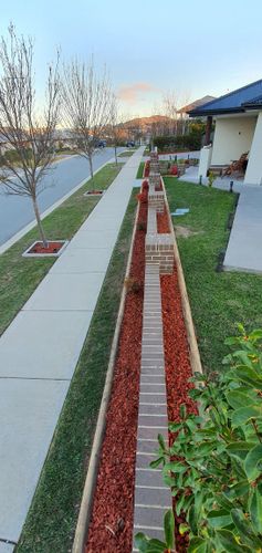

Were you considering this SpecRite 1800 x 902mm Pre-Oiled Merbau Alternating Slat Fence Panel or this SpecRite 1800 x 600mm Pre-Oiled Merbau Garden Fence Panel and would you be installing the with the longest side horizontally? There is a possibility of installing the 600mm wide panels with fixings and brackets into the bricks as it is quite lightweight. The 902mm wide panels are substantially heavier and would require post supports of some kind or very large brackets. They are relatively rigid, so you might be able to bolt them directly into the back of the brick wall.
How large is the span between the brick pillars on the wall? Would the panels fit neatly between them?

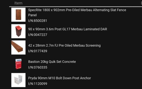

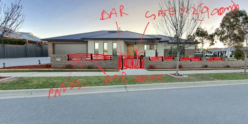

My plan is to use SpecRite 1800 x 902mm Pre-Oiled Merbau Alternating Slat Fence Panels) as half cut horizontally and this will be supported by a bolted in post (90 x 90mm 3.6m Post GL17 Merbau Laminated DAR cutted in 400mm) in between pillars of boundary retaining wall which wpuld perfectly fit. The span between the pillars is about average 2.9 to 3.2 meters. On side of the pillars to use (42 x 28mm 2.7m FJ Pre Oiled Merbau Screening slat cutted 400mm) as supporting side of the panels.
On garden side I will be using the (90 x 90mm 3.6m Post GL17 Merbau Laminated DAR - 1.2 m) as post in ground and 1800 × 902 Merbau fence panels horizontally.
Can you please advise if I am on right path. Like what screws I should be using to bolt in on bricks where using Dar and with Merbau panels on Dar and FJ oiled screening slats on sides of pillars.

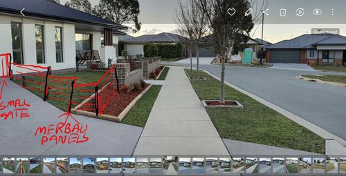

I am also going to use panels as gates. Please see marked photos for reference.
So far I have these items on my order

Hi @MitchellMc installing the panels on ground with posts for Garden area but installing the panels on bricks for retaining walls one as that will be on top of the bricks. So what will be bolts for them.?  Also how do secure panels on pillar side with that Merbau FJ slat. The middle part will be covered by post bolted in.

Hi @manbir_hanspal,
Could you perhaps draw a diagram to help convey the panel's positioning? That would be quite helpful when providing the required fixings. It sounds like you still use the brackets, but instead of screws, you'd use countersunk Dynabolts into the bricks.
