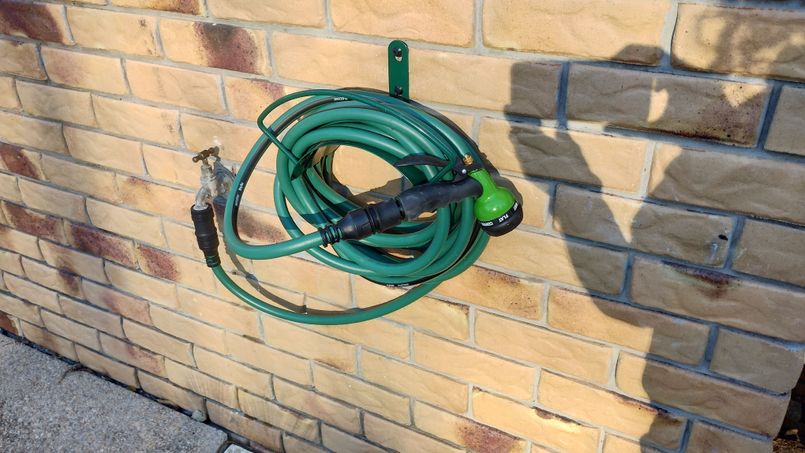

Well thats for the advice, i did end up getting the job done.
I went in a different direction with the fixings. I ended up using 40mm Nylon RamPlug Anchor and otter-12g 50mm black hex head screws
I don't know if its as good as your suggestion but certainly  seems like its on there pretty good. I even did another hanger for the front of the house.
we'll see how long it lasts i guess
hose hanger installedhose hanger installed

Nice work @joshy1, I'm sure it will stay in place for a long while.
