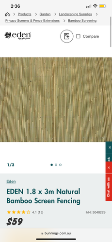

How to install bamboo privacy screen and artificial hedge in the balcony wall without drilling the wall? Thank you
