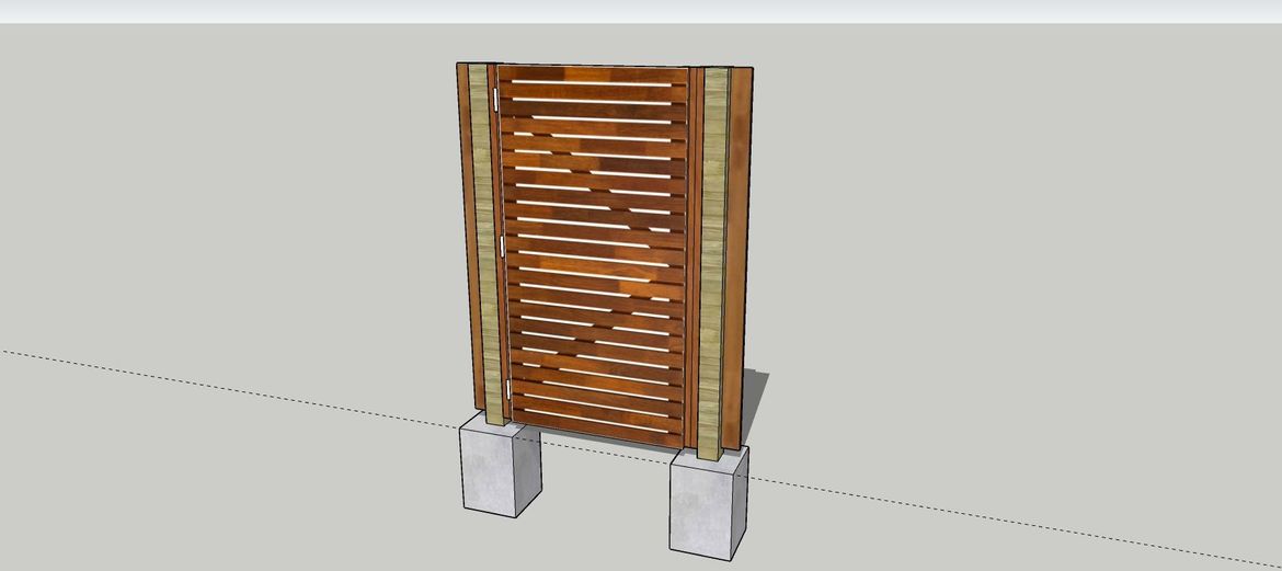

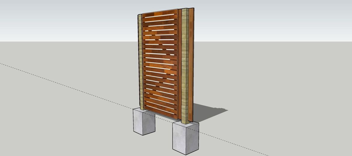

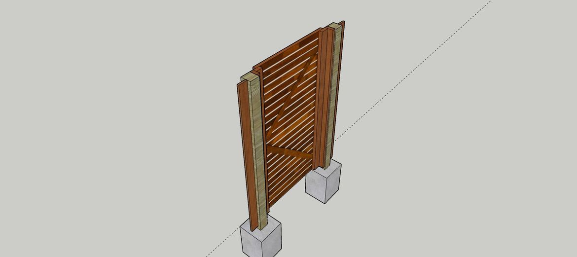

Hi @Case
Here are a few sample images to give you ideas on possible construction methods. The big grey blocks are the concrete footings for the post and the gate is made from SpecRite 1833 x 900mm Pre-Oiled Merbau Horizontal Slat Gate. The posts are 100 x 100mm 2.4m Post H4 Treated Pine Wet CCA - 2.4m and the filler panels are SpecRite 90 x 19mm Merbau Pre-Oiled Decking - Random Lengths - 90mm.

Hello @Case
If you look at the picture I've posted earlier, you'll notice three distinct hinges on the left. They would be white in colour and very small in the drawing. It indicates that the door opens outwards away from your PVC pipework. The best part of this design is that it can be switched to the direction that you desire.
The post is imbedded in a concrete footing. It does not need to be anchored to your wall. You'll notice that I've placed small Merbau panels at the side of the posts. Its purpose is to cover the gap between your wall and the post.
