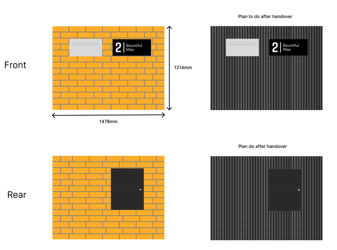

Hi team,
I'm planning to install Ekodeck Castellated Panels around my brick letterbox. I'm very new to this. How do I go about installing it around the letterbox? I think I need some treated pine to create a frame around the brickwork before installing the panels. Is there any other option that might reduce the extra width? I'm currently looking at about 61mm thick (timber + panel) around the brickwork. Any suggestions will be highly appreciated. Below is the plan.Screenshot 2025-04-17 at 4.34.47 pm.png
Thank you

Using 35mm timber is really the minimum you should fix above a solid surface. Ekodeck is a composite material and can deteriorate if fixed too closely to a substrate; your 35mm will allow airflow beneath it.
Given the panels need to be fixed every 600mm, I suspect creating three mounting points would be the easiest solution. I've created the rendering below to illustrate. These frames can be mounted in position with countersunk Dynabolts.

Hi Mitchell, thanks for the illustrations. It helps. The length of the brick wall is about 1550mm. How many dynabolts on each timber would you suggest. I live in Perth, WA where it can get very windy at times. Also for the castellated panels, what screws would you suggest? Thanks

I propose using a minimum of five Dynabolts with a gap of 300mm per bolt. I recommend using Zenith 8 - 10 x 50mm Galvanised Countersunk Rib Head Timber Screws to anchor the panel to the timber frame. Should you decide to use a different type of screw, please make sure that they are rated for outdoor use.
