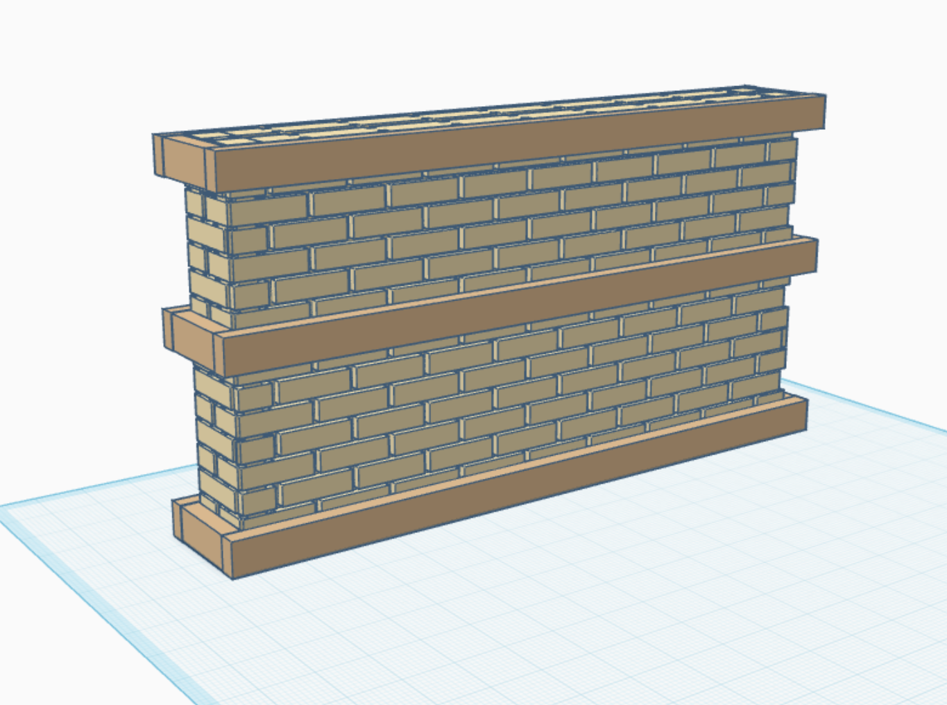

Using 35mm timber is really the minimum you should fix above a solid surface. Ekodeck is a composite material and can deteriorate if fixed too closely to a substrate; your 35mm will allow airflow beneath it.
Given the panels need to be fixed every 600mm, I suspect creating three mounting points would be the easiest solution. I've created the rendering below to illustrate. These frames can be mounted in position with countersunk Dynabolts.
