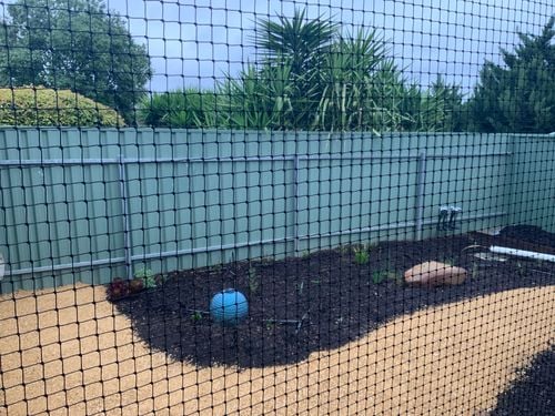

I am after some advice on how to attach a 600mm timber fence extension to my colorbond fence which has exposed posts and rails on my side. The neighbour is about to remove the yukkas (good luck!!😂) so the extension will provide privacy. The landscaping is a work in progress, it will be a while before screening plants are doing their job.
All of the resources I have found so far only seem to discuss extensions for the ‘good neighbour’ type of colorbond fences or timber fences. I considered prefab timber extensions, but they have  legs for both sides of a timber fence and would need to be modified to make them work - so thinking I would be better off just making a DIY slat version? I’m thinking along the lines of horizontal slats attached to vertical timber battens which would be tek screwed to the fence posts, with longer vertical battens mid way between the posts attached to top and bottom rails for extra support (not pretty, but plants will eventually hide the fence) .
