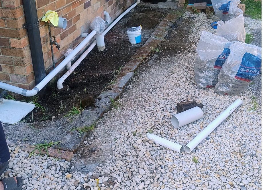

Hi all,
I am thinking to add a outdoor hot and cold shower to back of my garage.
Purpose is to rinse after pool so no shampoo or soap. But i guess we still have to comply as it has hot water.
The roof is about 900mm out from wall, and the pavers are about 900mm long. I know the with hot and cold shower, it has to be connected to sewer, which i have one nearby to do it. My question is wouldn't it makes the stormwater comes into sewer as well? How to prevent this? My options are
1. add 900mm linear grate outside of the pavers(easier to install as the paver sloped to outside but might not be compliant as exposed to weather).
2. Linear grate beside the 900mm paver (maybe compliant as it is less exposed.).
3. Cold shower only with or without 900mm linear grate connected to storm water. Hot water to be disconnected by ballvalve.
Thanks!
