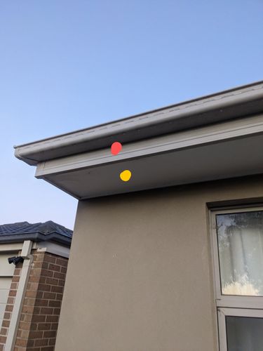

I bought a eufy wireless security camera that run by solar.
Realised that i have only two options to install.
Where would be the best spot to install the camera? Considering need of exposure to sun foe battery charging, the red spot would be better but is the eave able to hold the weight?
And what would be the best way to install that?
Please advise.
Many thanks

As the solar panel is on the top of these cameras, the red spot will be a far better place for installation.
It is unlikely that the weight of the camera would have a negative effect on the fascia, as they are generally made of timber that is around 20mm thick. With good-quality screws, you shouldn't have any issues attaching the camera to the fascia.
If the weight of the camera is still a concern for you, there will be rafters behind the fascia that you can screw into for additional support. They will run perpendicular to the fascia board and can be located with the use of a stud finder
You might like to have a look at How to use a stud finder for some guidance.
Let me know if you have any further questions or need any guidance.

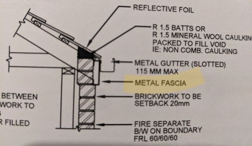

It appears that mine is metal fascia.
What is your recommendation here?
Re: install solar security camera
Hi @dogbural,
As the weight being supported by the fascia is not going to be much, you should be fine to screw directly into the metal fascia.
You can use a small metal screw such as these Buildex 8 - 18 x 20mm Zinc Plated Countersunk Ribbed Head Metal Tek Screws to screw the security camera straight to the fascia.

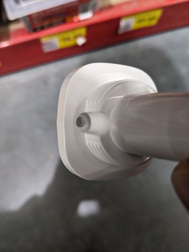

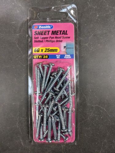

The camera mounting plate is like this, 8G is a bit too big.
Do you think this would do the same?
Hi @dogbural,
As long as the head of the screw doesn't pull through the hole, these will work perfectly fine.

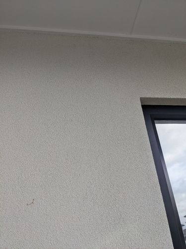

I have one side having a wall (dont know what it is called, is like hollow wall,, no brick). To mount it the camera, should i need to use a special screw or any type of screw anchor?
Nailbag
Hi @dogbural if you mount the camera on the wall, ensure it's in a location that gets plenty of direct sunlight otherwise over a short period of time the camera will never full charger, which could result in it shutting down especially at night. Bear this in mind as each time you access the camera for live viewing, you will be heavily draining the battery.
As far as actual mounting on any wall type, these 6mm Ramset universal anchors will do the job nicely. They are my go to'f for a lot of fixing projects.
Regards, Nailbag
Hi @dogbural,
@Nailbag has given excellent advice that I can't really add anything to. The anchors he has recommended will be perfect for this application.

Hello @dogbural 🖐
Best practice suggests 8 - 10+ feet above ground level is the most satisfactory mounting point for your CCTV cameras, higher will increase range and permit you to angle the camera down more to limit vision of unwanted areas (like neighbouring properties) with the benefit of getting the lens out of direct sunlight (and the associated glare), I would concur that the fascia is the better of the 2 suggested locations 👍
