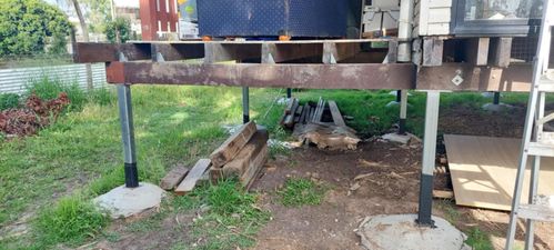

We need to add outdoor stairs to an external deck. We have purchased the Galintel 7 tread stringers from our local bunnings. What is the best way to attach them to our deck?
Our deck width is 2330mm and from ground to landing is 1380mm.
We also need to attach rails (any budget friendly suggestions) and was thinking of using the H3 treated pine stair tread 240 x 45mm x 1500mm. Can we do the 1500mm wide treads if the set the stringers at 1m width, with a 250mm over hang on each side of the stringer?
