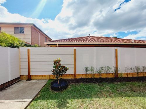

We recently got our new fence installed and now starting to plan out some landscaping.
I want it install some weatherboard panels to zone off part of the fence above where the deck will eventually go, using weatherboard panels in the image below.
From what I gather, I'll need to frame up portions of the space between the posts (RED) for the panels to be fixed to (BLUE).
Would love any input from anyone, particularly to do with type of timber, screws, brackets suitable.

I have another question lol, So the weatherboard panels look pretty nice, the flat paneling is under them? And if so Is that what you need to do to install the weatherboard sheets? or are you having it to define an area?
Sorry with the always questions ![]()
Good pick up there !
I am just defining the area with the weatheboards, where the deck will eventually line up to. There is no FC sheeting behind the weatherboards, just the timber framing built into the fence to mount the weatherboards.

Finally finished installing the FC weatherboard and the rest of the FC sheets. This includes a screen for the hot water unit and bins.
Next we'll paints it all, build a deck and lay fresh new turf but for now, we are super happy with it.

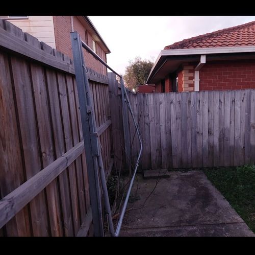

Before
