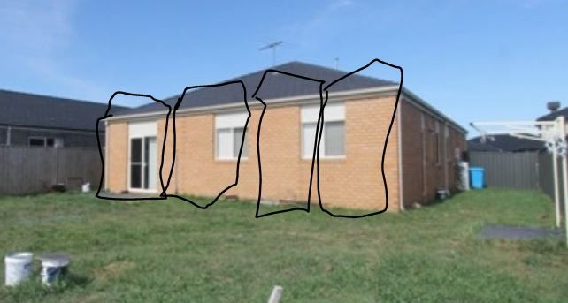

I have a big backyard with a concreated area of 12 x 4. I have a permit for a 12x4 pergola. However I am planning not to proceed with that given the cost.
I am planning to install 4 of Mimosa 3 x 3.6m Charcoal Palermo Gazebos together.
Just wondering are these gazobos have internal rain water pipes? and what's the best way to install 4 together.

I'm not too sure what you're looking at doing would be feasible. If you were to join 4 of these gazebos together, you would essentially be creating one structure which is well over the size that would require an engineers approval.
The main issue would be what's called "uplift". Attaching the 4 gazebos together would essentially create a big sail, which in high winds, even with adequate attachment to a concrete base, could be picked up and flung causing damage or injury that I think everyone would like to avoid.
Unfortunately with a structure this size, it is likely you're going to need to pay a professional.

I'm afraid that from a safety aspect point of view it is not viable to install 4 gazebos side by side. However, since you are willing to spend this much for your gazebo, I suggest engaging the services of a drafts person to draw up a gazebo plan for you to a set budget.
The drafts person will then draw up an official plan which you can then submit to your local council for approval. If you have the necessary tools and D.I.Y. experience, you should be able to build this gazebo. Or you could hire a trades person to build it for you.
