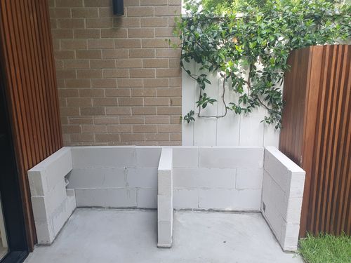

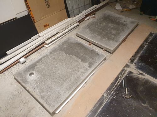

Hi, I am building an outdoor bbq using Hebel power blocks for the structure and concrete slabs for the shelf (on which the bbq will sit) and the benchtop. I used mortar under the first row of Hebel blocks and AAC adhesive to join the rest of the blocks. My question is what product I should use to join the concrete slabs which will sit on top of the Hebel blocks? I haven't been able to find an answer online.
