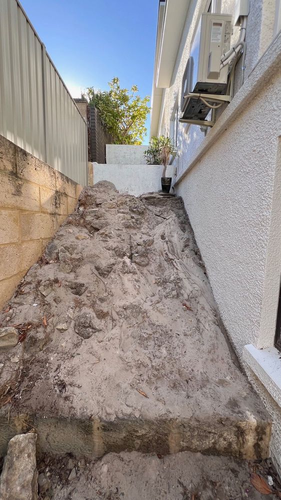

need help with a solution for a steep site down the other side of our house, causing high moisture readings in the walls.
Very sandy and has a layer of limestone rocks that are not cemented in.
I've partly removed the rocks  planning to remove the rest.

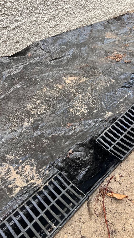

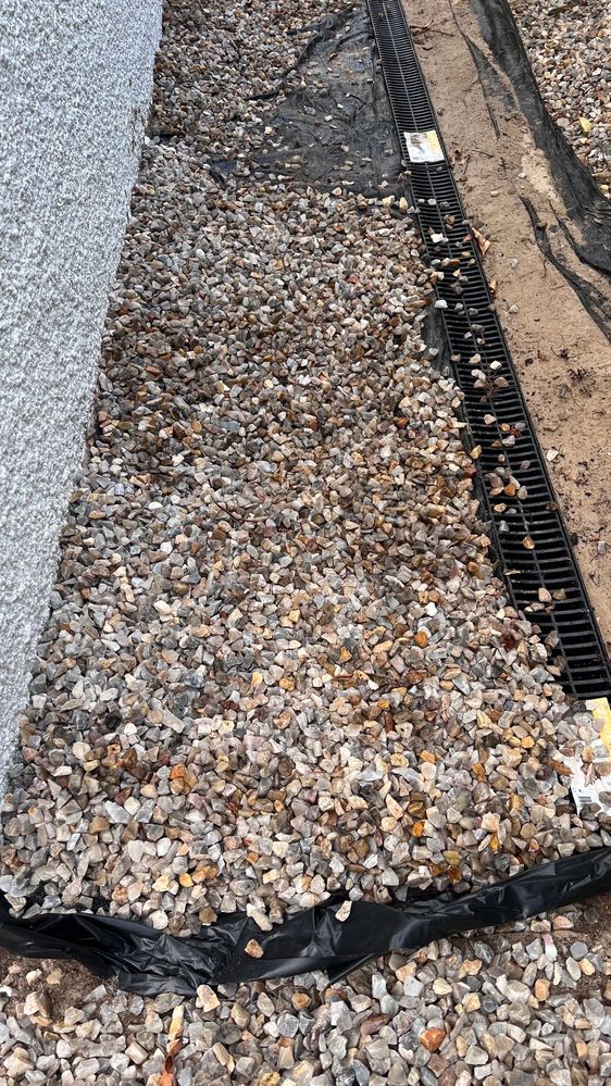

Top two level sections - installing drainage solution with existing and new plastic and covering with existing stones. Water will be piped down the slope. (refer images)

Planning to take out all the stones, remove some sand from the left side, to create a slope away from the house.
Relay the stones and cement all the stones to create a seal/hopefully keep the sand dry.

There was no existing outlet or drain in each wall until the recent work, just a wall with nowhere for the water to go since 1974. Water banked up behind each retainer wall/into the corner near the house wall on the top two levels, with a gap between the retainer wall and house wall for the water to pour down against the house/soil. Plan being that the retainer walls should have little water behind them/ keeping it on the surface with the new easydrain grates. But I need to allow for the agri pipe and I'll use 90m pipe down the bottom slope or two 40mm to allow for any extra work I need to do in the future, cheers.

sharing my progress where some details have change, can you help with how to make a cement slope where you can see the plastic?
all the way from top to the brottom, like to avoid cracking etc

The site is now stable and decided to use the rocks for a steps to the top but decided I don’t want these rocks all the way across like the original plan, I agri pipe installed.
Just keen to know what would be ideal to cover the plastic eg am I on the right track like the steps but with smaller rocks? Anything else that anyone has seen as a solution, thanks.

Any chance of some images of the area for a bit of context @bob11? You can typically mix up sand and cement into a consistency that will hold position on a reasonable slope. You might need to add some rebar to ensure it doesn't crack. Adding aggregate or small stones before it sets is an option.
