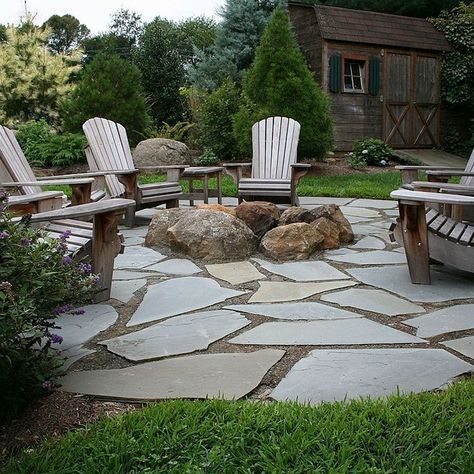

We are planning to do a small fire pit area with the left over 20mm bluestone pavers and granitic sand like the attached picture.
Not sure how do we start ?
1) Should we do a wet lay of the pavers first and then fill in the gaps with granitic sand or
2) Should we lay granitic sand first and then compacted and just lay bluestone pavers on top ?
Appreciate your help ! Thanks in advance !
