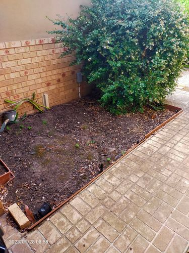

Hi All expert out there .. need some advise. I wanted to make the soil area brick paving similar to the right side of the paving bricks. Question is what type of bricks should I get and how deep I need to dig.. Also what layer I need to put? Do I put sand and compact it before laying brick and lastly cement powder and spray with water? Can I do section but section?

Hi @calccom21,
You might like to have a look at this helpful step-by-step article: How to laying paving for a path. The steps involved will be similar, and the article shows you how to prepare the ground. If you are just laying a bed of sand under the new bricks, then you'll need to dig the depth of the brick and 20-30mm more to accommodate the sand underneath. Once you've bedded the bricks you can set the mortar lines with a mix of cement and sand and then water it in. You can do sections at a time if that's easier.
I suspect you'll find it difficult to find matching bricks. So, you might want to choose another style and make a feature out of the area. Speaking of features, where is this area? Would it make a nice location to construct a small deck that you could place a three-piece furniture setting on and enjoy a morning cuppa?

Hi @calccom21
For a uniform look, I suggest measuring your brick before going to the store. Since there are no fixed rules on brick matching if you do decide to get something bigger, just try to imagine how it will look when mixed in with your current set of bricks.

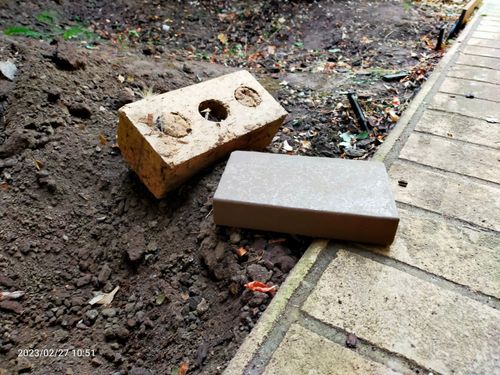

Thanks. Can anyone give me an advise here? As per my initial photo above, I'm planning to lay bricks paver before I put a decking. I saw a better but thinner paver than then normal bricks the photos below (left the regular bricks and assume than is currently on my floor) right paver stone seems better quality and smoother surface but thinner. Can anyone advise the pros and cons? And if Im going to lay the right side does that means I do no need to dig so much deeper hole?

Hi @calccom21
If the foundation for the paver has been prepared properly, the paver you've chosen should work adequately. Even if it is a little bit thinner than the brick, the amount of soil you'll need to remove only needs to accommodate the sand and the paver itself. Plus, the paver looks to be very close to the size of your current brick paving. From a deck footing point of view, you can always put a large paver above the newly laid pavers as the main base for an adjustable deck footing.
I suggest having a quick look at this featured project - Low-profile deck with screening and steps. by @MGusto. This shows you an excellent example of how the deck footing is laid out even on large brick pavers.
