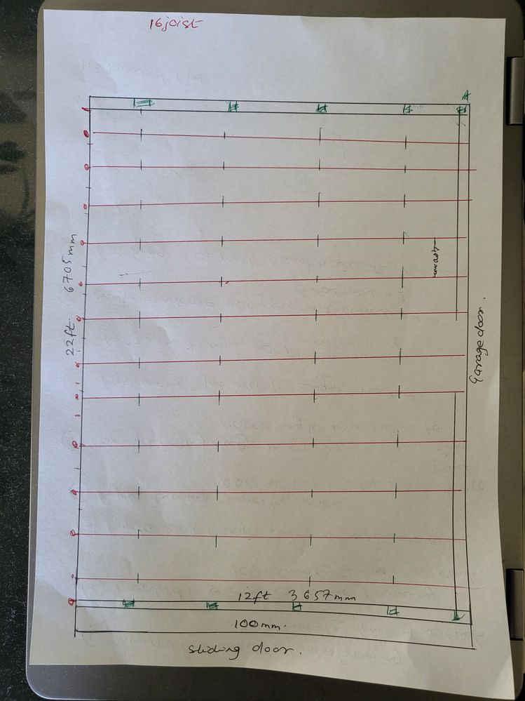

Thank you Eric. i think i will use the flat side as you suggested. As per the image attached could you please advise how many timber do i need for frame?
Based on your measurements and on the condition that you are using 70x 35 x 3.6-meter lengths you would need 20 joists that includes the sides of the frame. Please note that you will need to adjust your drawing as the timber is only 3.6 meters long. If you were to add noggins, you would need an extra 7 lengths.
