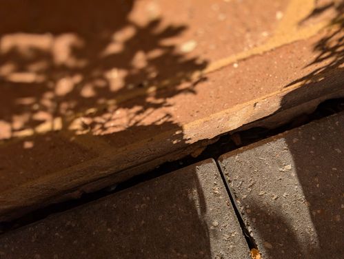

* I noticed the current pavers don't really meet the house well. Should I do something about this? Or is a slight gap ok?

For the gap between the pavers and the wall, you can treat it like an expansion joint in concrete. Adding an expansion joint will stop debris from building up in the gap and give you a nice clean finish that allows for slight movement. Check out How to fill a joint in a concrete slab for some guidance.

Also thanks so much for the advice re. the gap between pavers and wall - it felt like such an obscure issue, I wasn't sure If I would have much luck. I'll check out the resource you provided.
