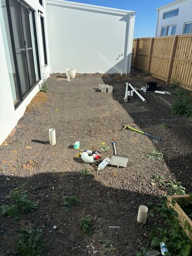

I am going to be paving our courtyard area as well and was going to have that concreted first and then add pavers on top of that. Is it possible to just compact crushed rock and have a sand base? Or use mortar mix on top of crushed rock? @Nailbag

@MitchellMc has made some excellent suggestions re: contacting the supplier of the Travertine. They really are the best positioned to advise on the most suitable methods for both your concrete slab and side area for fixing the tiles. As far as a base goes for the side area, a crushed rock thats been packed down has always been the starting baser any paving project.

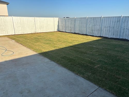

Hi there,
have posted previously and now ready to start tiling. An issue I’m having is the edge of the slab we poured isn’t drying out since I’ve laid the grass. It was bone dry before we laid the grass and is fully cured. Seems the watering of the grass and the moisture from the soil is keeping it wet. Can I still go ahead and lay the tiles? If not what can I do in this circumstance?
