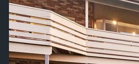

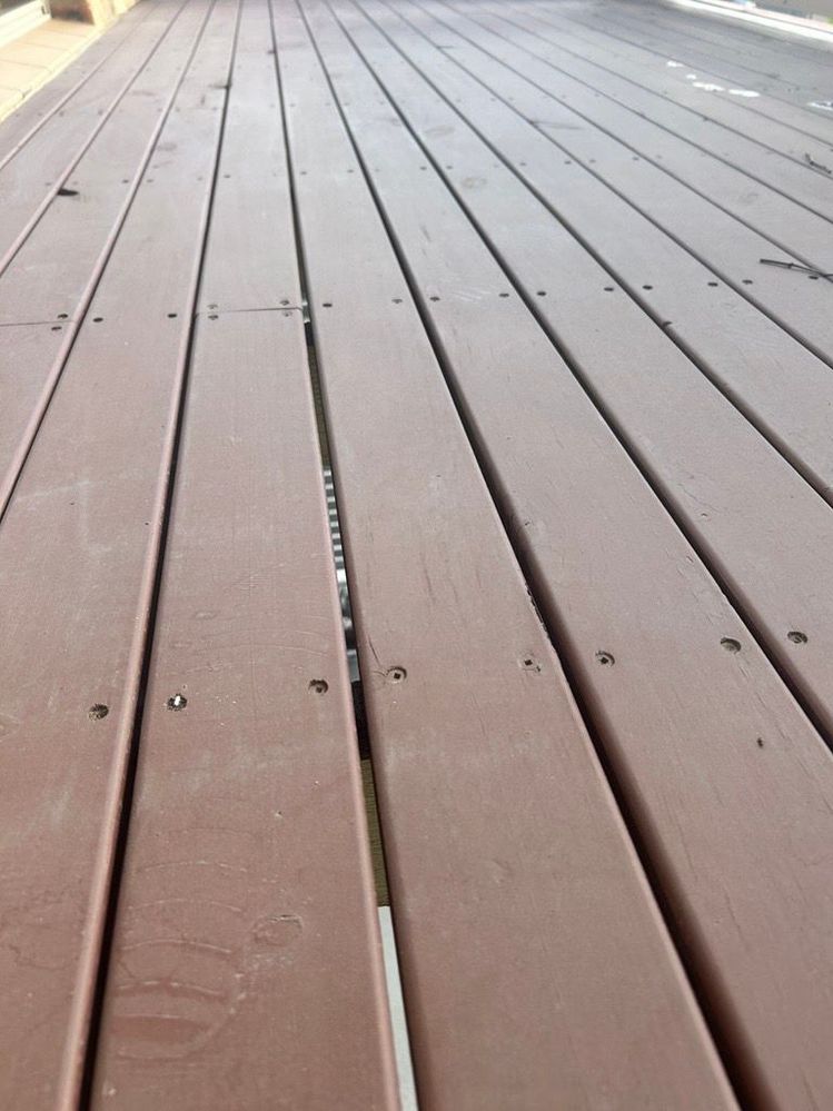

I have started a bit of research on how to maintain our outdoor timber pieces like the deck and railing. Attached are some images which show the material. I think the decking is ekodeck which according to their website just needs annual clean with hot water and soap. But I am not sure about the railing. Can you please advise what is the correct way of maintaining these railing timbers: paint, oil, stain or sealant or combination?
Thanks heaps
Siver
Re: Outdoor timber maintenance
Hi @Siver,
You are correct that Ekodeck requires no maintenance beyond cleaning. As it is a composite decking product, made of a combination of plastic and wood pulp, there is no need for oiling.
If the paint has fully sealed the timber, then they should be fine with just a pressure clean every year or so. Exterior paint will generally last for a minimum of 10 years and can, in the right circumstances, last much longer.
It is worth touching up the paint on your railings every now and then, but they don't look too bad from the photo provided.

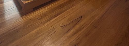

Thanks for the detailed response, JacobZ. Much appreciated! Can I also ask your advice on how to maintain my indoor flooring? Does these meed any regular oiling
or staining?
Hello @Siver
It is a different situation in regards to interior flooring. because it is technically protected from harsh weather and sunlight it does not need to be oiled or stained that often. Sweeping and mopping the floor is enough maintenance to keep it in good form. The occasional use of Long Life 1L Self Shining Floor Polish to give it a bit of a shine is also recommended. The only time the floor needs a proper revamp is when the finish starts to fade, and you have sections that are starting to look very dull and worn away despite using floor polish. It's an indicator that the timber sealer has finally reached its end of service life and needs to be stripped and resealed.

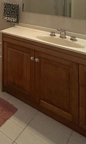

Attached are images of the kitchen/bathroom cupboard, it doesn't look like polyurethane coating, but honestly I'm not sure.

For the cabinetry, unless this is new bare timber, a moisture-resistant coating should be applied to it, which is typically varnish. Normally, you wouldn't have to do any maintenance on that.

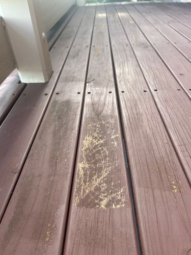

I tried soap and a low pressure wash on my ecodeck and it seems that the paint peeled off in some spots🙁
Is there any fix for this?
Many thanks
Re: How to maintain outdoor timber railing?
Hi @Siver,
Sorry, I missed your original interaction about the decking. That's timber decking, not Ecodeck. In your first image, it wasn't as obvious, but in your latest one, you can clearly see the pine knot holes and natural defects; Ecodeck has none of these, as it's a manufactured board.
In order to restore your painted pine deck, you should give it a good scrub down with Sugar Soap and flush with clean water. Allow it to dry and sand any areas of paint that are flaking or are damaged. Clean it off again and wait for it to dry. You'll then be able to coat your deck with exterior deck paint.
