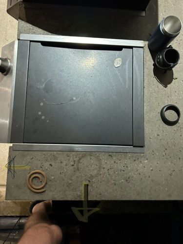

hi I’m wondering if I’m able to make my current top about 2 inches wider on the front & side edges for more overhang maybe another 1/2 inch thicker all over to seal & polish better as bbq stains or would it be easier to remake ?? 🙄👍👍

Mmmmm finding it hard to picture your current concrete countertop :smile: Any chance of a few pics, an overall one, some side profiles and maybe one showing where you want the overhang to be extended?

Love that countertop :smile: Not sure how thick it is. I am starting to think that it may be easier to construct a new one then modify this one. Mostly because I dont know how you could bond the new part to the old part with enough strength to support the weight. And that just raised anther question, what supports the current concrete bench top?
Thinking outside the square, I wonder if you could give the whole bench a hardwood timber edge? That way you could expand it out without having to concrete it.  I am thinking of something like this 135 x 19mm L/M Decking Ironbark KD Standard Maybe not all four sides, but the front three sides. I went for a lighter hardwood comparedto the usual Merabau as I think it would look great next to your concrete. How bad are the stains on the concrete?

As @Dave-1 has said, it would be very difficult to attach concrete to the side of your countertop in a way that would bond well, be supported and look nice.
Unfortunately, if you wanted an extended countertop made entirely of concrete, you'd need to start again.
If you want to attempt to pour your own, you might like to check out How I poured my concrete kitchen countertops from @mcscc for some inspiration.
If you weren't confident pouring your own countertops, I like Dave-1's idea of attaching some hardwood as an edge band. This would give you that little bit extra space, while still maintaining a nice look to the countertop.
