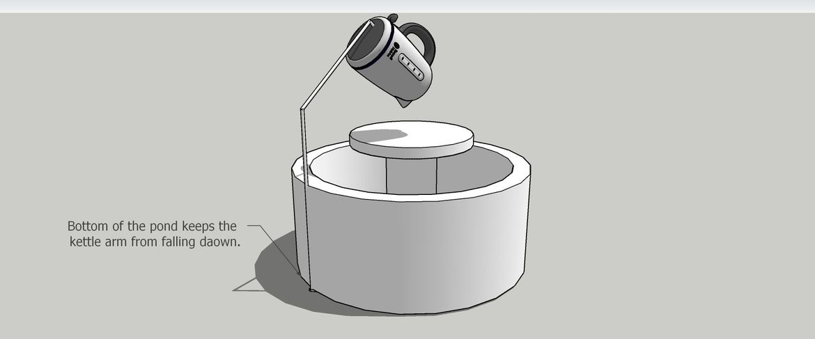

how to make a water feature with water pouring out of a jug into bird bath

It's definitely a challenge, but I think it can be done. I suggest having a look at this guide - How to create a pond in a pot by @Adam_W. Although not exactly what you were after, this project gives you the basics of how it might be accomplished. If you have the right pond and a birdbath that fits inside the pond the water pump can then direct the flow of water to the jug and then out to the birdbath. The overflow will simply fall back into the pond.
Give me some time to draw up a plan on how it can be put together.

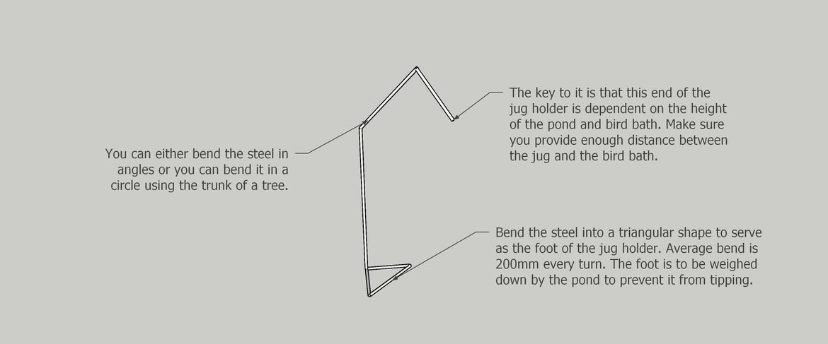

Sorry for the delay. The design I've created is dependent on the pond and birdbath that you purchase. If the pond is too high you will have to use a thicker piece of steel. But if you keep it low say 300mm then the parts I'll be mentioning should work out perfectly. The maximum height you can have is 400mm bird bath included.
I suggest using Whites 7 x 1800mm Reinforcing Wire - 3 Pack as the jug holder. Using a heavy jug will bend the steel out of shape. Make sure to use a jug that is made of plastic and not too heavy. Pond size can be as big as you like but it must not exceed 300mm in height. The birdbath can go as high as 400mm but no more than that.
Please have a look at the assembly instructions and if you have any questions, please let me know.
