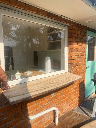

Hi guys! We have a piece of timber cut to attach to this window sill to make a servery bench but are unsure how to attach it! Its a brick sill on an angle underneath which makes it hard
Any suggestions?

I suggest having a look at this discussion - How to install outdoor servery bench below window? by @Holdent. Their window set up is very similar to yours. Generally, what you need to do is install another piece of timber on the angled part of the brick and fix it in place with Dynabolts to act as support for the bottom of the benchtop.
Here are a few more amazing servery installations our Workshop members have shared:
We did exactly the same thing and David actually put a wooden panel into the front of the sloping bricks and then screwed the bench into that. By doing that the bench doesn't slope with the windowsill if that makes sense. I think I posted the process on Bunnings Workshop but I also did a video on the whole thing. I'll put a link to the video and you can watch the whole process if you like, just skip the bit of me talking in the middle😁😂 It actually turned out so well which shocked both of us and it almost looks a little bit like a floating shelf from some angles. Good luck with it!

I was going to describe how to make a bench and install some brackets but I watched @daniknight4 's video
Thats a nice job they did and really it satisfies all the same things I was going to suggest but in a nicer look! The only thing Id do different and its only a personal choice is that Id oil the timber instead of staining and varnishing it
I really liked their little end covers for the bricks (windowsill)

Well I think your idea and the implementation really nails all the spots
I cant add tro it. Definently an idea I will keep in mind for use myself.
Thank you @Dave-1
It started out a bit iffy but we are really so pleased with it😊🌸
