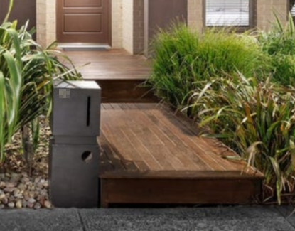

Hi There,
I'm looking for the best way to make my front entrance path more disability-friendly for my parents. They have trouble with steps.
any advice for budget friendly solution please?

My first thought was converting this stepped deck into a ramp, but this would likely be costly and require the assistance of a licenced carpenter as council's often have stringent regulations on ramps and the requirements surrounding them. If you wanted a permanent structure that is both functional and good looking, this would likely be your best option, but wouldn't be the most budget friendly option.

Any chance of a wider profile shot?You can block out the hous e number if you are concerned
The reason i ask is I am wondering if your driveway is at the same level as your doorway? Potentially you could build a path between them.
@JacobZ's suggestion about convert the front path to a ramp is where I went to first, Little concerned about steepness especially as people get older.
How about redoing the path so its diagonally off to the side and then diagonally back to the door. That way the slope is halved (distance is incresed tho) and its an easier walk. I do like the idea of handrails at least one side incorporated into the project.

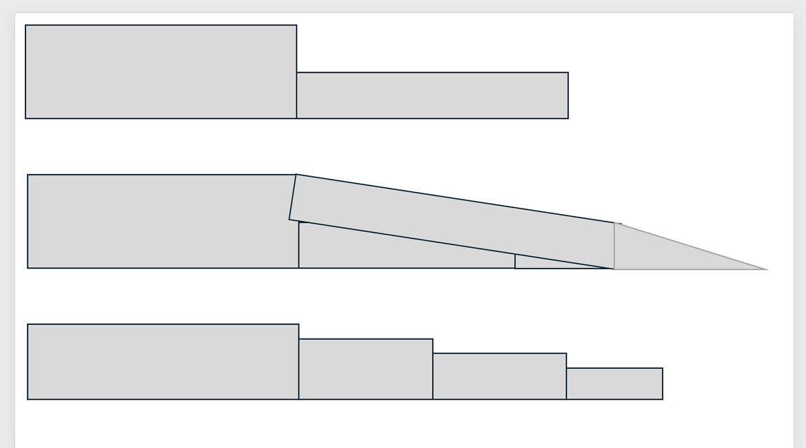

If your parents are like mine they may resist the idea of change, maybe do a few sketchups of the ideas you have and see if they like a version?
Hi @jonsnow Not knowing what difficulties your parents have, two suggestions would to be to either non-slip ramp the existing two platform or to build intermediate ones with shallow steps. Each step however would need to be clearly indicated so not to create a trip hazard.
